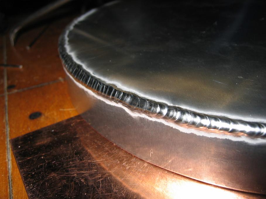

You probably won't need any pre-heating for your 1/8" thick, 2"x2"x2" aluminum cube.
To answer your question - I have pre-heated parts to successfully reduce distortion caused by the cooling weld bead. Often, a little distortion is manageable, but sometimes (welding next to a machined surface) distortion can be an issue.
The other benefit pre-heating can provide, especially with aluminum, is a reduced amount of heat from the tungsten necessary at the beginning of the weld. This can sometimes let you weld with a sharper, smaller diameter tungsten, or with a smaller machine than would be otherwise necessary. And it can reduce the time you spend with an arc struck at the beginning waiting for a puddle.
I don't see much good coming from waiting in one spot with an arc struck for a long time, so its best to avoid it if possible, and use more current. No sweat when you're learning though. If your tungsten is maxxed out (tip melting, or degrading like forming protrusions, etc), switch to a bigger tungsten, or a lower DCEP/cleaning setting (to take heat off the tungsten and put more into your work.) Sitting there waiting for an arc can be bad IMO, because it is more opportunity to touch your tungsten to the work (and make a mess), or get an uneven etched pattern, or excessively heat up your work, which can result in a less controllable (potentially "runaway" size) puddle happening as you get further along your weld bead. Often times to get enough current at full footpedal depression, we have them adjusted so we lose some fine control of low currents on the lower end. And a large tungsten, especially with a "used" tip, can have some issues at a really low current settings too. So, we often have limits of how far we can reduce the current while welding. When things are set up right, we should be able to complete the weld comfortably between the limits (upper AND lower) of what the footpedal and tungsten (and whatever other variables may be limiting...) allow.
You really don't need much DCEP/cleaning to get the job done on clean aluminum. So try turning the DCEP/cleaning setting down, and focus more heat into the work and take it off your tungsten. For 1/8" material, I would probably use a sharp&blunted 3/32" tungsten, and somewhere in the ballpark of 30%-20% DCEP. I'd probably set my machine at about 125 amps @ pedal full down, at least for starting out on room temp pieces. You can practice forming a puddle and maybe a dip or two on a piece of same thickness scrap, to make sure the heat is right. I like to aim for being able to get a puddle quickly at about 3/4" footpedal travel. Quite often during the "test puddle on scrap" step I like to do, I realize I forgot to open the argon bottle or something. Forgetting to switch from DC to AC can be a real doozie also. I'd initially press down enough to get a good arc start (minimize the high frequency "lightning", which can make unsightly scars on your surfaces), then over the next 1-2 seconds, gradually press down increasing the current until I get a puddle, ready to dip filler with the other hand, when a good sized puddle is reached, dip the filler in and move. Prepared to regulate (pull back especially) on the current to keep the puddle size roughly constant. For full penetration, I'd also try and melt a small melted "keyhole" and bridge it over with the filler rod. It will leave a little bulge inside where it melts through, but it will be strong and as close to fully penetrated as you're going to get by just welding from one side. If your filler hand is getting behind, or futzed up or whatever (I've had my filler glove work its way off), you can always pull back on the footpedal to shrink your puddle; its a little better than extinguishing the arc completely (avoids the white etch around the arc restarts.) You've just got to hold the torch still while your filler hand "catches up". If you are going for full penetration, at the "keyhole" puddle stage, you've got fractions of a second to fill it, or you'd better pull back quickly on the footpedal, or it will melt back and leave you with a hole. You can fill a hole, but it will cause a wider bead in that spot, which while can be perfectly functional, just won't look that great. But heck, you're learning, so if you make a hole, no big deal, try honing your skills on patching it closed, its kind of fun.
I recently did some .80" thick, fully penetrated corner joints. Hope this helps!

- IMG_0035_small.JPG (72.53 KiB) Viewed 1891 times
something i recently welded, i held the arc on start up for a little bit to pre-heat the area then got to work..no warpage, no issues. yada yada
also...something i learned, the balance settings are useless...you dont even need them the trick to that is....dun dun dun...you ready???
CLEAN YOUR METAL!!! brake cleaner first phase, wipe it down and clean it nice, then!! very important!! denatured alcohol!!!! clean off the brake cleaner very well....this works great for me, i produce the same bead quality time and time again just by prepping my metal the same everytime..no gaps, super tight EVEN fitment, and make sure its ULTRA clean... you will be damn amazed at how well your beads come out after you start cleaning better
