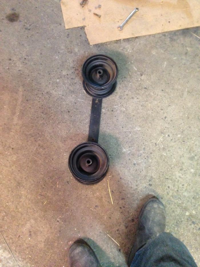

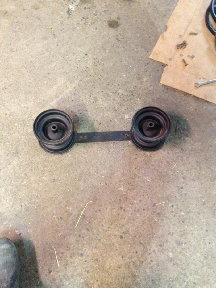

Two lawn mower rims.
Piece of 3/16" by 3" flat bar----about 2' long.
welded on, two 3/8" holes drilled, and lagged into studs.
I need to make some more of them.
~John
~John

I'd recommend having the plate stick out on the sides of the rim, and screwing to the wall there, instead of in between.

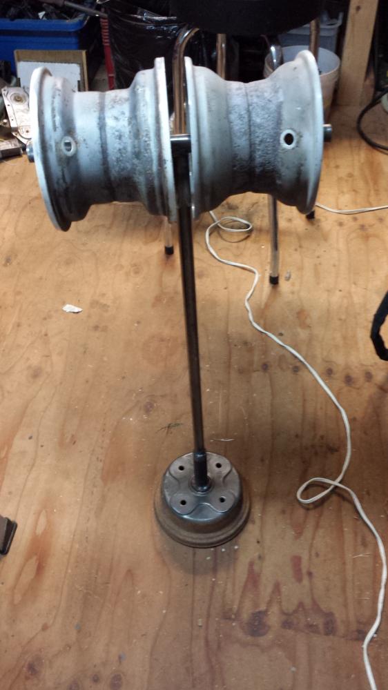

Here's another design for lead holders with wheel rims....

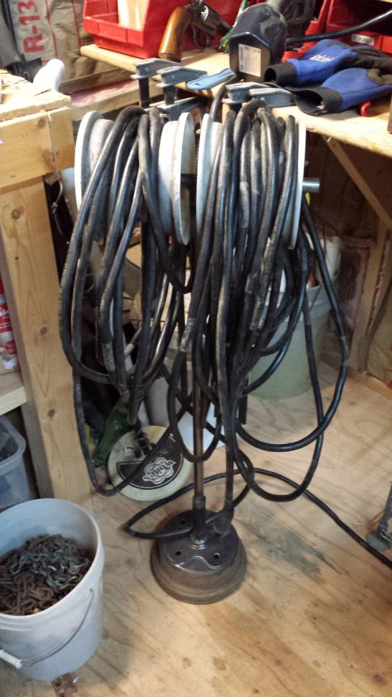

Well, this is what I ended up doing; after scrounging around the shop a bit, I came up with a couple of lawn tractor wheels. My drops bin yielded a bit of 3/4" tubing and an old wheel hub.. the rest should be self evident by the photos. It can be placed here and there or used as a dead-man in a pinch.

Thanks again everyone, I appreciate your time & ideas.

- The layout
- 20141107_171823.jpg (39.77 KiB) Viewed 1363 times
- The new cable tree looks nekkid
- 20141123_221540.jpg (64.27 KiB) Viewed 1363 times
- 20141123_221626.jpg (75.76 KiB) Viewed 1363 times
- 20141123_221922.jpg (86.17 KiB) Viewed 1363 times
