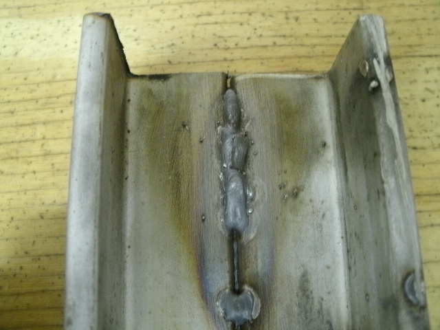

I had a MIG welder refuse to perform Tuesday. It could not be set within any range I was familiar with, refused to penetrate, and generally was worthless.
This was .035 308SS, at 20.2V and 345 IPM, using Tri-Mix (90% He, 7.5% Ar, 2.5% CO2)
I could blame the machine, but I'd seen this before... I'd done it by mistake once before, sooo
Here's the "weld" produced by the bad-gas bottle:
Here's the weld, same machine, same settings, with another bottle of Tri-Mix known to be good:
Bad/contaminated/mislabled gas happens...

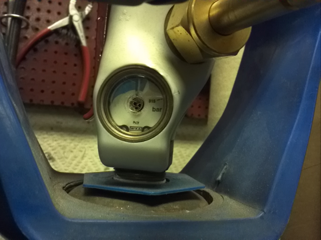

We have pressure gauges on the bottles now so you can easily see if the bottle is full or not before leaving the yard

The Genie cylinders are very nice but are still being filled in a trans-fill situation so there is still a chance to get either a mislabeled cylinder or the introduction of moisture. The built in gauge is a nice feature though, I didn't realize they had that feature and the regulator being protected in between the handles is smart. I'm not sure if they're available here yet or not.

Here's my bottle
Here's my bottle
- IMG235.jpg (234.06 KiB) Viewed 1161 times
- IMG233.jpg (213.19 KiB) Viewed 1161 times

For bottles with integrated regulators, I've seen these in use, although I haven't used myself.
One trailer manufacturing operator stated that they were a great way to go. Just quick-connect the gas line from the MIG and you're ready.

Yup Genie serie bottles are avaible in sizes of 10 and 20 litres with 300 bar.
Gases avaible for Genie series at the moment, here in Finland:
- Argon
- Nitrogen
- Argon mixes for Mag-welding
- Nitrogen/hydrogen mix for root protection on stainless.
We haven't tested those yet, but I think that those bottles would be more than ideal to be used in pharmaceutical factrories or so.
