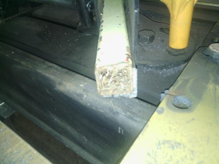

First off. The way to cut mitres on angle, or angle 3mm thick and under is to pack the angle in the vice with a piece of square tube the same as your angle. IE: 1" or 25mm angle = put a bit of 25mm square inside the angle, the length or longer than the jaw of the vice. Problem solved. This is pretty much the first thing apprentices get taught here in aus, but it never occurred to me that you wouldnt know it, due to your non metal background.
2. The cold cut tct saw is a savage beast. Remember the teeth are very similar to a wood mitre saw, and most likely spaced about 2mm apart. The perfect size for a bit of 1/8 angle to get lodged in if you are not careful. I somehow managed to get a metal fencing picket to slip under the teeth and get flung away. Not good.
3. I would use the trick that i mentioned first off, but extend the square tube past the line of your cut, so you are cutting the square tube AND the angle. This will stop the teeth from catching on the material. Happy time. Slow and steady.
I only have an abrasive drop saw but i will set up a pick for you.
Mick
Mick

Some pictures for you hopefully the explain my ramblings
- Angles put together, note jodys 3rd hand tools.
- IMG_20140908_164900_506.jpg (44.39 KiB) Viewed 1985 times
- Close up
- IMG_20140908_164647_048.jpg (69.59 KiB) Viewed 1985 times
- After cut
- IMG_20140908_164254_594.jpg (28.59 KiB) Viewed 1985 times
- Clamping before cutting
- IMG_20140908_163632_854.jpg (35.31 KiB) Viewed 1985 times

Firstly....Thank you so much for taking your time to help me with this situation....And the pics of your miters look great....That was exactly what I was looking for !!! Just had no idea on how to get there.
No ...I have had NO experience in cutting any sort of metals with a saw....and I knew there was a big difference between a piece of wood being under tension and during the cut jumping out on me... than a piece of angle iron flying around the room !!! Truthfully, it made me a little nervous....I am too old to get whacked in the head with big ole piece of steel ...I survived my Ex-wife so I don't take as many chances as I use too !!! This has been surely frustrating up to now....Your explanation and pics have help me so much in how to approach this...and for that I am very thankful.
I did find another post on the Hobart forum of a 2008 post of a " Jig " a guy had made up with angle iron for 30 degree and was making 1 for his 45 degree miters....pretty impressive looking homemade jig that put him in perfect alignment.....but for the first time I did notice in his pics that the "Fences" on a vertical band saw are a lot more heavy duty...thicker....than the fences on these dry saws...and looked like the band saw would lend itself to safer working environment...but I don't have a vertical band saw ....so I am just going to have to work with what I have and pray......But I did wonder if that type of jig would work as well on the thinner wall fences....
I think " Your " ideas and approach are much better.....I am going to borrow all of them !!! And if you don't mind I may pick your mind from time to time.....since you have already gone through all of this .

You have made one of the best purchases possible.
I have used this saw daily for the last 10 + yrs doing exactly what you are looking to do.
Once you get comfortable with it you will be able to dial it right in.
We cut channel, pipe, square tube, angle for frames, brackets, supports, unitstrut in carbon steel and stainless steel all day.
Blades are specific to the task and material as well as expensive.
With the proper cutting rate / pressure (minimum spark) they last a fair amount of time.
Cut is nearly burr-free with minimum clean up required.
No smell of the abrasive wheel is also a plus when working in an occupied space.
Advice you got earlier of utilizing a small piece of square tube inside of the vise when cutting angle iron is right on point.
