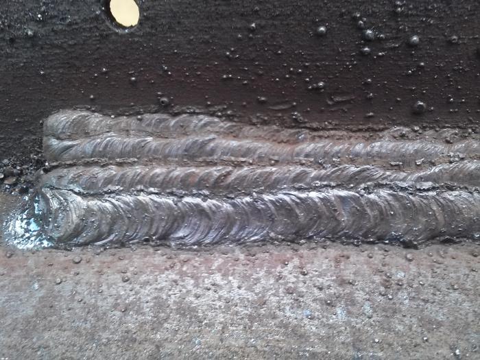

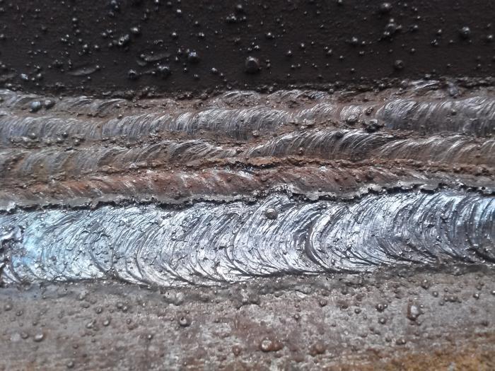

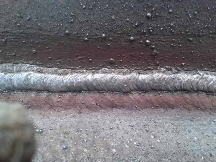

I told mbmalone that id try to run some 6010 next time i welded. Well...yesterday was that day.
School has been out for a little and i havent had a chance to burn some rods so i started with 6010 beads. 1/8 rod, 80-90 amps, flat position.
I had an old piece laying around that i used to practice T joints on so i just burned on top of that. I left the plate dirty as hell.
I dont think there's much undercut. It looks like i undercut the heck out of it but im pretty sure thats just mill scale and slag. If i used a wire wheel i think itd be better, but all i had was the good old chipping hammer and wire brush.
I started pretty straight and then i dont know what the hell happened hahaha. I dragged some, i did little script E motions/circles, and i moved around in a ( motion on others.
Just some practice beads on sh*t metal to show mbmalone what 6010 looks like when i do it.

ok, let me check all these beads with my inspection flashlight. Is that some undercut I see, hmmm?
No, actually what I see is a lot of splatter, not undercut. I'm sure it's just magnified. Since you didn't go over 90A, I was wonder what you had the arc control set on? Maybe that was set too high for the 6010. The way I understand it is that in the flat position, you want to have it in maybe the lower 1/3 of the selection range or you will have a lot of popping. IDK ... or 2/3rds for out of position. Maybe I have it wrong. I think 7018 is always to be set 2/3rds to 3/3rds of the range, no matter what.

I dunno anything about dunking rods in water man sorry. And i havent burned Hobarts before. My lws sells Lincoln and Weldcote. I have a 10lb box of the weldcote 6010 and a 7018 but havent tried them yet...
I wouldnt put so much emphasis on arc control and dig. Especially for running beads...
Either way, my machine doesnt have all those fancy things. Its got a knob that says crisp xx18 and soft xx18 and crisp xx10 and soft xx10. From what i understand these are preset dig functions.
As for the spatter i wasnt really going nuts cleaning it. U can see the pic of how dirty the metal was...just putting some beads down to practice burning. With 4 kids younger than 4 im just excited to get some under the hood time haha.

I only dipped the old 6010. If you google you will see it. Lincoln electrodes are nice, I'll not buy any more Hobart. I want to hold a tight 6010 arc, but without DIG I stick at the amperage I want to run, so I get pissed. I don't always clean either, not for practice. If I hit a little bump in the road where I'm welding my bead, with arc control it burns through, without I just stick the electrode. I know it's because I suck, but the arc control used to really help me with that stuff. It's like going to Hawaii and swimming, then coming home and the water is brown. It didn't used to suck, but now it does, ha..ha..
