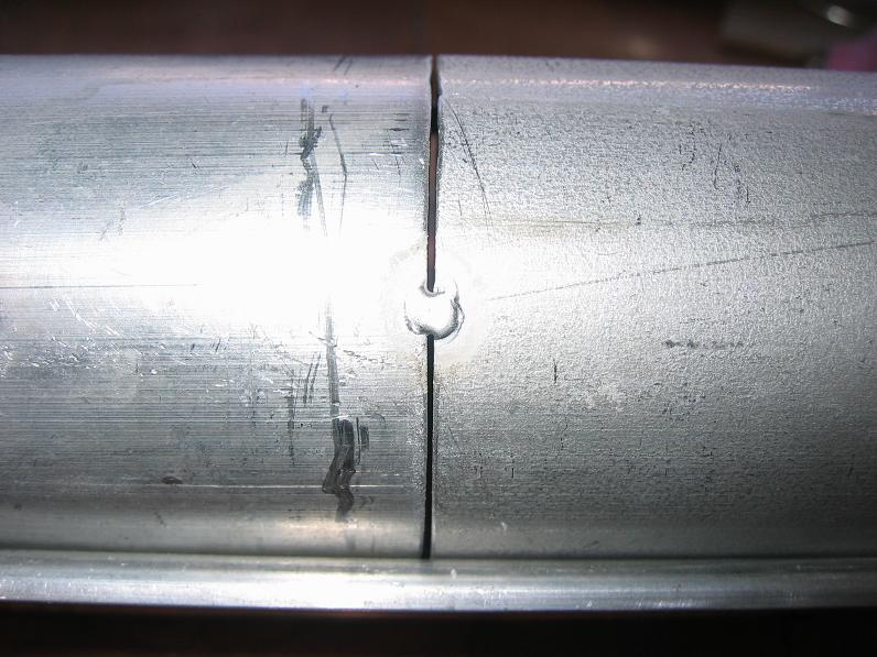

I have some aluminum round tubing, .065" thick that is mandrel bent, and of uncertain alloy. It is significantly more malleable than 5052 however, so maybe its something like 3003.
I have tried welding it to 5052 sheet and also to 6061 tubing, using 4043 filler rod, and in some cases I experience some small "hairline" cracks right through the weld bead, always right where the two materials join. The crack shows up almost immediately, upon cooling of the weld bead. The tiny crack shows up so quickly, you can't even hear the metal go "tink" like sometimes tack welds go when they pop apart.
I can re-melt the cracked bead, and while hot it seems like it flows together nicely, but the crack just comes back immediately. And it seems that trying to penetrate deeply does not solve the problem - the crack just comes right back, almost immediately, just the same.
Pre-heating seems to help some (OK actually, maybe quite a bit). As does it seems, going slower (maybe because that pre-heats the part) and not trying to penetrate as much. (OK maybe that is more because when going slower, I am worried about melt-through.) I noticed that the problem seems to be reduced after getting the parts hotter, so I think pre-heating seems to help. On the last tubing sections I joined that had this cracking behavior, I also went over it with a second pass, not deeply penetrating (IE: more arc length to spread the heat out) and added a more pronounced, raised bead for some extra strength. But I am not totally satisfied by this because the pronounced bead just looks a little ugly.
I should also mention that I am fitting the parts up tight. I am curious if I fitted the parts up with a gap, to be filled by filler rod, if that could eliminate the cracking. (IE: prevent the dissimilar parent metals from flowing together)
I have not experienced this cracking behavior before welding 6061 to 6061, to 5052, with 4043 or 5356 filler, etc. I've got more of these mandrel bends that I'd like to use on upcoming some upcoming welds/projects, so I'd like to learn to become proficient at welding them.
Is this a common problem for certain alloys, and what are the common solutions used?

Gary - thanks for the ideas, however "hot and fast" was the first thing I tried and it actually seemed to have the cracking problem really bad. I'd be surprised if this were a contamination issue because the molten puddle when it is a liquid seems to be flowing together just fine. (And there are no other signs of it being a contamination issue.) But I will double check I am using a clean ss brush and acetoning well on my next attempt.
Also, I have experienced the crack when fusion welding 6061 and 5052 together, and it just seems different than what I am getting. I recall the crack on the fusion 6061 and 5052 necks down and goes "tink" and kind of indicates that there are some stresses being generated from cooling that pulls the bead apart until it cracks. The cracking behavior I am seeing more recently however seems like it happens before the material has even cooled enough to generate any stress... there is no "necking down" of the material around the cracked area, and the crack is a tiny hairline crack through what you might think otherwise looks like a sound weld bead... it is pretty weird. Almost like it is forming when the aluminum is "slushy" (between liquid and solid.)
I did some research on cracking, and found lots of technical material on it actually. But I'll try and simplify it to what I think might be applicable for my case. Basically, certain alloying ingredients of aluminum at certain mixtures ("just the right" amounts... not too little... not too much...) are highly sensitive to hot cracking. By joining dissimilar metals, we are "mixing our own" alloys in the weld bead, which would be a combination of the two parent metals. We can control the alloy to some extent by filler rod selection, and also controlling how much % of filler rod we mix in ("diluting") to the parent metals composition.
Here are the popular aluminum alloying "ingredients" that can cause problems with crack sensitivity:
Perhaps the one that is giving me a problem is silicon? I can't really rule anything out since one tube I am welding I am really just guessing about. (I just know that it is pretty ductile...)
The way you control the filler rod dilution is supposed to be by joint prep... IE: by "veeing" the joint or leaving a gap instead of a tight fit-up. (Or perhaps, by the tall raised bead I tried, but I am not satisfied with that.) I haven't tried the gapped aluminum fit-up before, because I always hear as a general recommendation to "strive for as tight of a fit up in your parts as possible for best results", but maybe if its a uniform gap it will work OK? I think I am going to give it a go and report back here.
I am also kind of curious to see what welding on some 2024 aluminum I've got is like. Just to see how the hot cracking compares on a material that's supposed to be "unweldable".

I tried another weld with everything the same (same parent metals, same surface preparation, same filler rod) except that I fit the parts up with a small gap (stood the pieces apart using a .035" mig wire), instead of fitted up tightly like I did at first. I also did no pre-heating, to keep as much the same process as before, to test only the effect of the gapped fit-up. Result: the gap made it weld nicely, without any tendency to crack at all!
By fitting the parts up with the gap, I was basically forced to add a good bit of filler rod to get the two pieces to flow together. Before with the tight fit up, the pieces flowed together with very little filler, so only a small amount of filler was added here and there. I guess I can't rule out the possibility that the filler rod cooling the bead had an effect, but my feeling is that the dilution of the alloy with additional filler rod is primarily what got rid of the hot cracking behavior.
So next time you hear someone say "to get good results TIG'ing aluminum, fit the parts up as tightly as possible without any gap", know that there are some exceptions! I found that a uniform gapped fit still allowed me to obtain a decent stack of dimes weld bead appearance.

- First tack weld
- IMG_0020_small.JPG (83.88 KiB) Viewed 3623 times
- Completed "stack of dimes" weld bead
- IMG_0022_small.JPG (55.81 KiB) Viewed 3623 times
- Ground and polished, making the weld nearly "disappear"
- IMG_0033_small.JPG (78.79 KiB) Viewed 3623 times

You figured thru it on your own my friend, .... good job! The problem you were having was exactly that, ..... not enough filler rod. On the tight fit up it is exactly as ya found. Very tempting, or compelling is maybe a better word, to be skimpy on the build up, and that is exactly what happens. The thin strange mixture will immediately not withstand the thermal stress and crack before you can flip your hood up! You also saw that it got better with better attention to preheating, but even so you have to get some material in there and a VERY slow reduction and torch swirl, adding another cap layer on that last bead if necessary. You've got good instincts. Looking at your weld, you just need more confidence in your abilities you have! Wet in, move along at a good but controlable clip, but finsh slow, take your time on that last crater fill. Nice bro.

Oh yeah, one last thing if i may. Especially if your going to grind the finished weld, forget about the "stack of dimes" thing! Get your dips in there more frequently as the larger steps thin the material build up and by nature stretch it thin. Get in there with 2 dips or adds per second approx. and you can do tight fit ups on .062 wall with good penetration, and a nice rounded bead profile!
Thanks Lou - I appreciate the thoughtful words. I like having things to think about and improve for my next welds. I think you are right, I am going slower on this than I could with more practice. I am finding it tricky to get the torch to "rotate" around the pipe! And I am probably a little bit intimidated by burn-through. (Or rather, "excessive penetration", leaving a big blob on the inside of the tube.) More experience on TIG'ing round tubing will probably help. But the dissimilar alloys I think were also making this really tricky.
I tried the stacked dimes just for practice. With my methods and tools available (hacksaw, etc) it takes me a while to prep each weld, so I figured why not try it. And I think you are onto something (thanks!) that faster travel speed and more frequnt filler rod adds would make a better looking bead appearance. I've laid down some really good looking bead sections before (memorable occasions ), on flat sections mostly where I had pretty fast travel speed and pretty small, frequent filler rod dips. I don't know why it can't be done more slowly, but faster travel with smaller dips seems to give a more evenly "glossy" (less grainy) bead appearance. If I had a better set up fixture to hold the tubing vertical (so I could weld horizontally rotating around it), I think it would be easier to rotate around the pipe and weld longer more consistent beads. These welds were mostly with the tubing laying close to flat on a table.
Anyhow, what I didn't picture before the ground/polished bead, was I took a second pass around it to smooth the "stacked dimes" down evenly before sanding/polishing. I have pictured that below. It left me without much material that needed to be removed. And there was no problem with any cracks appearing from any reheating (I was curious to see if there would be.)
