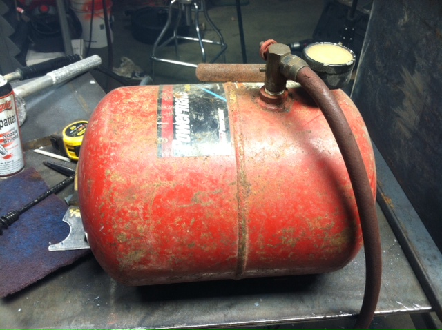

I have a strong interest in the dying art of forge welding and blacksmithing. I do not know very much about either one, I guess you can call me a noob on this subject, but have been looking into building a forge for about a year. So here is a shout out to anyone who has a interest or has a forge and wants to share some tips and tricks. Anyone here forge weld or do any ornamental blacksmithing?
To start I am going to build a gas fired forge, starting this weekend, following these basic plans;

The main reason I like this one is it is inexpensive and can be made by anyone, even with basic skills. I also have a air tank laying around so this will be perfect.

Here is the air tank I will be starting with. I will be making a trip to the store to pick up material in the beginning of the week. I actually got sidetracked with making a anvil. I have started a thread in the "projects" section of the forum for the anvil.
