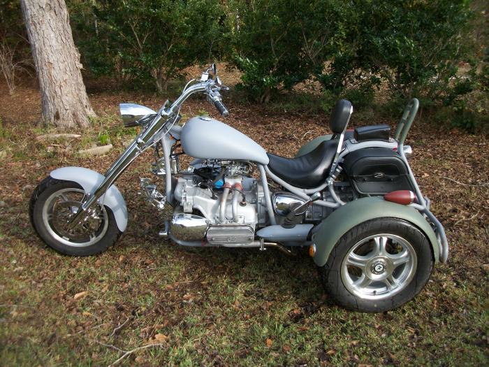

I am including a link to my first trike project, just to show what CAN be done as a metal fabricator.
This tike was a rear engine VW trike that had a horrendous, unsafe frame. Everything from the VW subframe was cut off and rebuilt and pics of the finished machine can be seen here http://s1061.photobucket.com/user/marci ... t=3&page=1

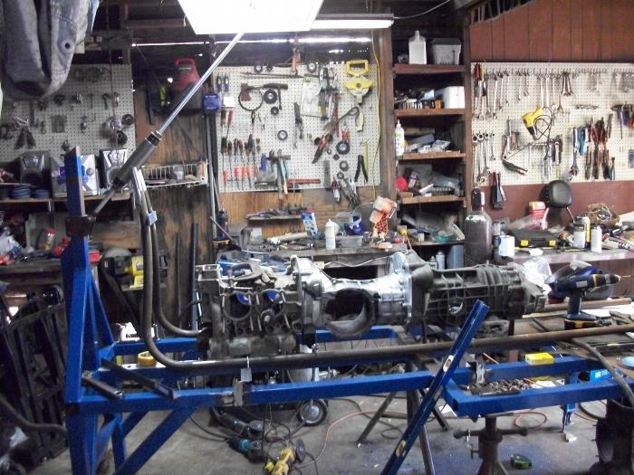

My current project is a mid engine trike powered by a Porsche 914 engine and transaxle. It has a gutted VW transaxle case that holds the clutch and starter tying into a jackshaft cut from the 914 transaxle mainshaft that was gutted to use as part of my dummy powertrain. This pic shows the beginning of the project.
The next pics were taken about 10 months later. I worked on this project on my spare time, as I work a 4-10 schedule at Austal USA building LCS's and JSHV's for the US Navy.
This was all fabricated and welded using cutting wheels on a 4&1/2" grinder and my old 185 Eastwood MIG welder (since died, replaced with a Longevity 200 MIG).
This is the first time I have posted any pics of the mid-engine trike online, and have not allowed pics taken by any visitors. I fabricated the frame and rear suspension out of 1" and 3/4" SEAMLESS sch 40 pipe. The design is based on the Swedish style trikes, but going way beyond, utilizing a stronger, cooler running engine and a 5 speed overdrive IRS transaxle, rather than the old 4 speed swing axle trans that the Swedish builders use.

Those are fine looking trikes I like the "industrial" feel of the first, with the diamondplate, rectangular saddlebags, and the cargo bed. Was this the theme of the trike before your frame rebuild?
The mid-engine trike is particularly impressive. It's difficult to build with all those curves and have it all flow smoothly.

There was no "theme" of the first trike other than get my disabled friend some safe transportation. The theme of the trike before the rebuild was "garbage".
I donated all my time and a large amount of material and parts. The rectangular saddlebags are from and old truck tool box that was cut apart and reworked into 2 boxes and the desire to get the battery and electrical out of the weather. As this is his only transportation, the bed on the back was somewhat a necessity. He also has a small enclosed cargo trailer that he can use to haul stuff with. I have incorporated a receiver into both trikes rear bumpers. We added a pair of large leather saddlebags to the first trike above the rear fenders along with a huge remote oil cooler and filter setup and a marine grade fuel filter/water trap since those pics were taken.
I appreciate the comments about the "flow" on the mid-engine machine. I actually started calling her "Flo" about 3 months into the project. Another pic showing one of the tubes tying into the bottom rail

Yes, it's a Porsche 914 engine, "W" block 1.7L. I also used a 914 side shifter transaxle, as it has the correct rotation and 5 speeds (mid engine car). Not all VW IRS transaxles can have the ring gear installed on the other side, which has to be done, unless you really want 4 reverse gears and 1 forward. The transaxle can also be flipped over, which also creates it's own set of issues. That is the reason almost all Swedish trikes are built using swing axle transaxles, the ring gear is easily moved from one side to the other, changing the rotation of the trans, to accommodate the powertrain being swapped end for end. Even then, the teeth of the gears are now being loaded on the wrong side. The swing axle suspension is much easier to build
Since the 914 is an IRS, I fabbed upper and lower A arms, to hold the hubs. I didn't submit pics of the rear suspension. I spent hours and hours of research to find the parts that would work, and I'm not so willing to throw all that info out on the net.The trike I built is my prototype, I'm hoping to eventually make this into a business. The next machine will incorporate changes, including the rear suspension.
