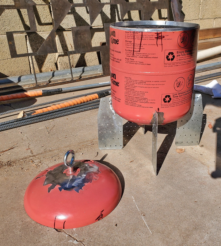

I'm making a mailbox out of one of those party helium tanks. It's coming along fine, but I cannot figure out a hinge for the door. The big box hinges that are narrow enough have quite a bit of slop in them and are the sturdiest designs when only one is used.
I was wondering if anyone has a design or know of a vendor that might have something that is fairly rigid laterally and narrow. Ideally it would mount on the inside but if exterior is the only way - so be it. Mostly if it can survive a mailman having a bad day, I'd be happy lol.
Thanks for looking.

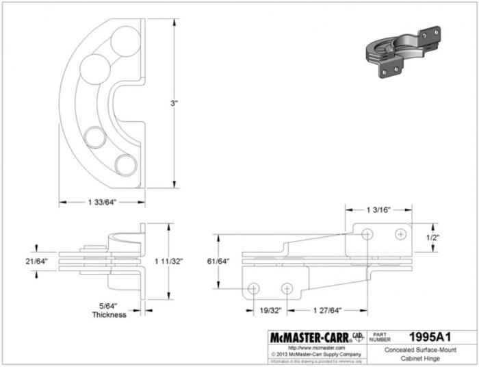

A couple hinges like this might work:
https://www.mcmaster.com/1995A1/
You might need to make some blocks with tapped holes to mount them inside if you're trying to hide the hardware.
- dudley
