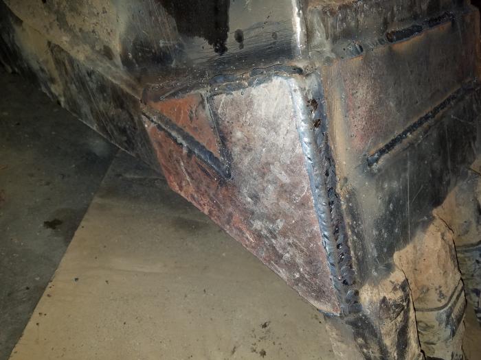

Got a call at work the other day from an operator asking for his frost bucket. There's no frost and now I'm baffled by it, but this guy knows his equipment and has been a dirt worker since Moby dick was a minnow, he says wait till you get here you'll get a laugh. This is what I pull up to...

Some heating, prying and beating it's stuck together

Some carbon arc gouging and welding the sides back

You can never have too much reinforcement ![Very Happy :D](./images/smilies/icon_e_biggrin.gif)

I was welding the reinforcements in while he was still digging. I pinned the bucket down with a mini excavator, bent it back with a big pipe wrench and a 8 foot cheater.
That bucket was about 4 years old and a lot of hours on it with no type of hardfacing, just wore paper thin and he hit a rock. Just another day playing with dirt.
