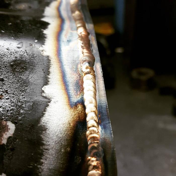

Morning all, I have some questions about my discoloration in my silicon bronze on mild steel. My pattern is fine and my welds are solid but the color is nasty, but only sometimes regardless of prep and cleaning of parts material and filler. I have pics , not sure how to post them.
- IMG_20170331_141102_849.jpg (63.57 KiB) Viewed 1214 times
Juni...I have played with SilBr quite a bit and in my experience, the bad color comes from including your base metal into your braze and gas coverage and how clean your metal is. Brazing is a fine balancing act of heating the base just enough to melt the filler and not the base. Jody has a couple of videos about tig brazing. I am not sure but I think he made some piggy banks and used SBr for color but I want to say he used AC current to get really nice color. I have never tried AC on Sbr. Aluminum bronze on AC turns out really nice color.
I couldn't speak about that as I have never tried it. There isn't a whole lot of conversation about tig brazing as it's generally considered an artistic form of joining metal and not really a legitimate form of joining metal so trial and error might be your best bet. SilBr and AlBr is used alot in cast iron repair and for joining dis-similar metals. In the real world...there isn't much use for joining dis-similar metals other than the artistic aspect but I have used SilBr to fix broken gear teeth on cast iron pieces and that is an accepted use for it. Six of one and a half dozen of the other I know I wasn't much help but I triedJuni_1976 wrote:Thanks a lot, I never used ac on metal. What about pulse? Do that help at all?
