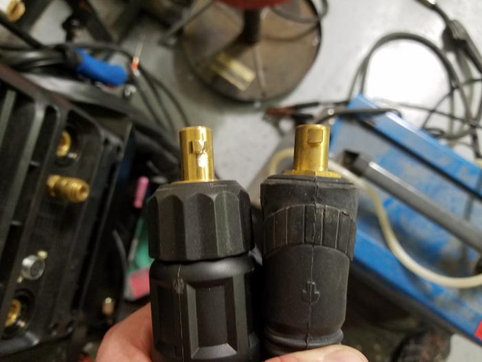

Ok I have been gone 2 years and i just got my tig welder back and tried to hook up my ck torch. Now i could have sworn i used it before but now it wont lock into the slot. It looks different than the other connectors that do fit. What am i missing here?

I don't know the exact details, as asked above the welder would help, but the left lug has it's locking lug further up the side of the round stud, and the whole round portion appears to be longer than the one on the right as well.
If they line up other than the length of the "nose" beyond the side locking lug, you might be able to shorten the tip slightly, but it could be an entirely different application connector.
Is the CK one designed for water or gas through the connector, and the one on the right isn't? Maybe the other way around? If that is the case, you'll need to sort out the differences, and correct the plumbing before continuing with the CK torch set.

These two links should help you identify what you're working with. You have two different Dinse connectors there and with some measuring, then comparing to either the shopping list or the PDF, you'll know what you have. I'd guess the left is a Dinse 25 and the right is a Dinse 35-50. I find the 2nd is usually called a Dinse 35 but some call it Dinse 35-50 but I believe the variable is when it's a Dinse connector that can be stripped to accommodate a larger wire. That last bit is a guess but the rest should be true.

I got one of the Ck adapters and the lug on the dinse connector was too far back towards the welding lead and i had to grind almost 1/8" off of the locking lug on the side before it would fit in my machines at work. (dynasty 350 and everlast 256si)
