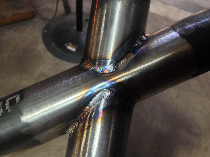

welding up some new body mounts for my TJ jeep (laser cut and pre-bent from SWAG Offroad), 1/4" thick, and boxed with nice sliding angles. MUCH stronger than the factory mounts, un-boxed and probably 1/8" thick, and not angled well to slide off of rocks. Most of them are folding over and bent real good from hitting bolders.
Anyway, since I have 6 of them to do, I figured I'd try different welding techniques on them all. I've done 3 so far, first was Flux core, 2nd was MIG, and 3rd is TIG. The flux core while it's penetrated well, isn't much to look at. The MIG to me looks just fine. The TIG could use work on consistency with the pedal and torch movement. First time TIGing with 220 power, I didn't have any filler rods larger than 1/16", I think a thicker filler rod would really help with the now higher power.
TIG is still new to me, so I think I'll do the rest of them with the TIG machine to get more practice. And then when it comes time to weld them onto the frame of the jeep in the driveway, I'll probably MIG them if the wind isn't bad. if wind is bad, I'll hit them with flux core wire. Can't fit a jeep in my garage anymore
