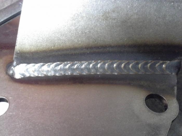

Nice dimes mate....
AK, does that new ESAB still have the buttery smooth arc that the old migmaster 250's had? Used to have an old Ltec 250. Arc was so soft I thought there was something wrong with the machine the first few times I used it. That was coming from a lincoln 175+
When good welds go bad. Very bad.
Mick
Mick
