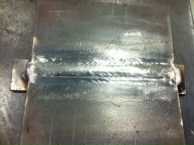

I did this the other day but thought I would put up a picture here too. I had to re-qualify for my AWS D1.1 in the 1G position, 1" plate. Specs; ER70S-6 .045, 26-26.5 volts, 280-300 ipm and 240-260 amps. I would say this is probable the easiest test one could take, in my opinion anyway.
I will be re-qualify for others as well and will get pics of those when I take them.

Well, that sure as hell passes VT!Superiorwelding wrote:I did this the other day but thought I would put up a picture here too. I had to re-qualify for my AWS D1.1 in the 1G position, 1" plate. Specs; ER70S-6 .045, 26-26.5 volts, 280-300 ipm and 240-260 amps. I would say this is probable the easiest test one could take, in my opinion anyway.
Good luck on the other re-quals!
Thanks Steve!!

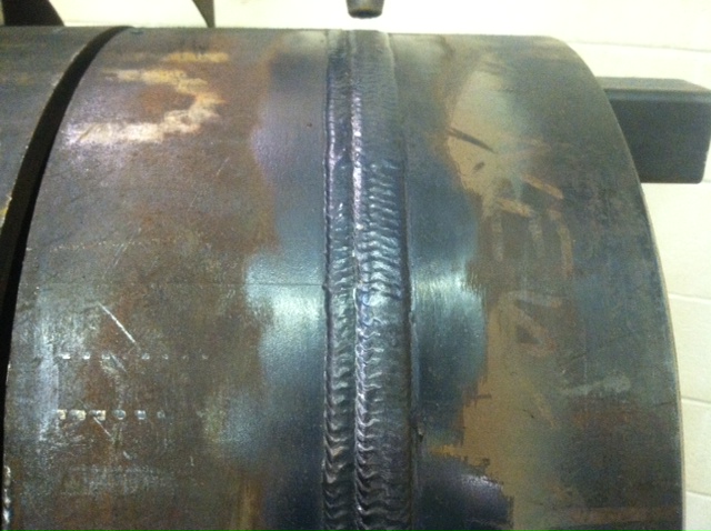

I went to Weld Tooling Corporation, or Bug-O, on Thursday to view a demonstration on their Piper Plus orbital welding system. I found their system to be very nice. One thing I liked about their system is the data logging and user interface. The system performed very well and we started the demo with a semi-automatic STT root followed with 4 passes with the automatic using 81M. Vey nice system if anyone here is looking for a orbital weld system for their shop. I do not think we will go with this system but is it nice none the less. I have used their Mod Drive system about 1 year ago and it also worked very well, will have to dig those pictures out sometime.
- bug-0 weld.JPG (123.58 KiB) Viewed 1509 times

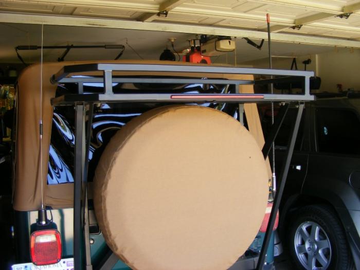

Newbie here. Tried my hand at Stick Welding and learned the ability to stick 2 pieces of metal together. Then took the plunge and bought a MIG Welder for home projects. This was my first attempted MIG project:
- TJ Rear Rack w/Third Brake Light recessed
- TJ Rack 01.jpg (55.66 KiB) Viewed 1534 times

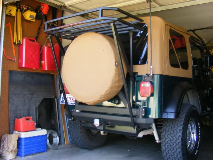

- A little closer view
- TJ Rack 03.jpg (46.41 KiB) Viewed 1534 times
135boomer,
Welcome to the forum! That looks VERY professional in my book! I like that. I will show it to some friends with Jeeps. I have never seen a rack quite like that, very unique.

Welcome!
That' not just "first time" nice, that's nice by any standard. Probably not your first time fitting up!
I like the placement of lynch pins to break it down nice and compact when it's off the jeep. Is that from plans, or did you design it yourself?
BTW, how is that hi-mount brake light attached? Self-adhesive? The low profile looks really clean.
