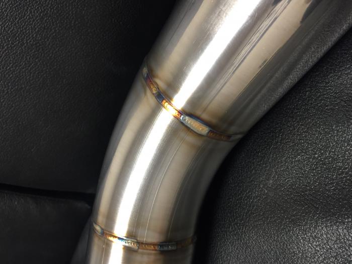

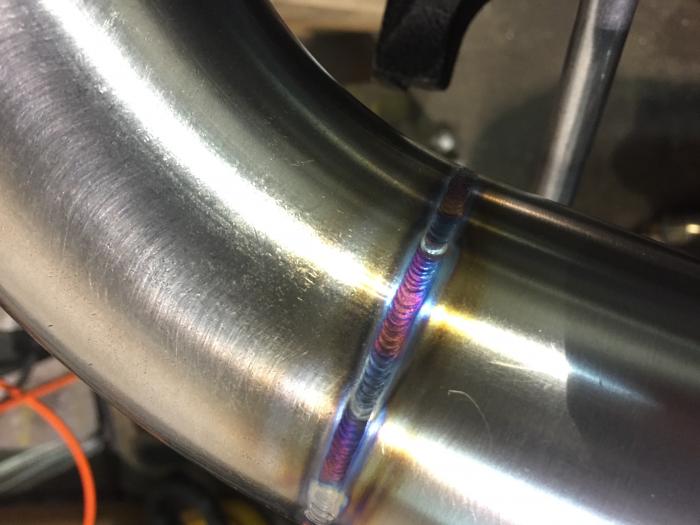

Thanks for the kind words guys! I am still learning and progressing a ton with each job. Sorry to post again so soon but I was doing some more exhaust work today and these are my best welds to date IMO.
- image.jpeg (70.53 KiB) Viewed 1855 times
- image.jpeg (31.82 KiB) Viewed 1855 times
- image.jpeg (41.85 KiB) Viewed 1855 times

did you use the same stick out as shown to
achieve those pretty welds?
if so what kind of gas flow?
very nice!
very nice!
AFR_Autoworks
- AFR_Autoworks
Hey Craig, yes I did use that amount of stickout. I almost always run 25 CFH unless I have to do some insane weld where I need more stickout. With this cup I have been able to run over 2" and still see coverage.

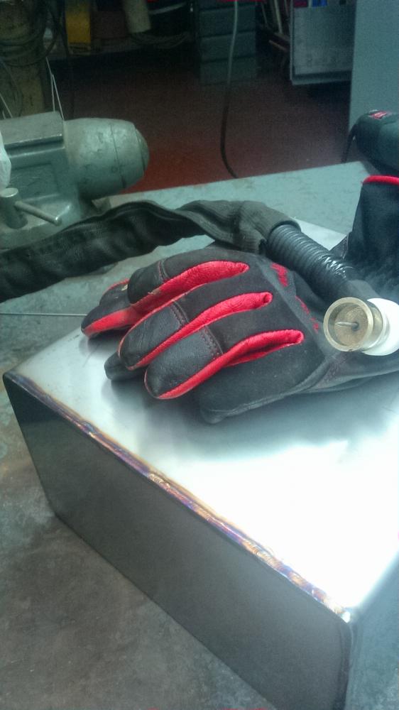

Finished up a bunch of little projects last night at work, have a full workload today have to finish welding up a filler.
- IMG_20160722_172342.jpg (59.21 KiB) Viewed 1956 times
- Rocking with my Superior Welding Unbreakable Cup
- IMG_20160722_192958562_HDR.jpg (47.41 KiB) Viewed 1956 times

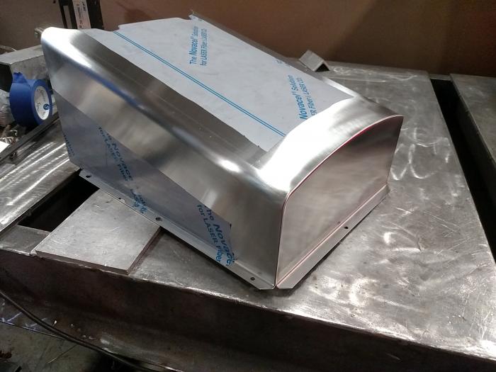

sticking with the 4B stainless theme... I think this is a wall mounted garbage can, maybe for biohazard waste? It's for a hospital.
We use the Walter 2 in 1 wheels to polish and fix/replace grain. Same idea as in the post above.
