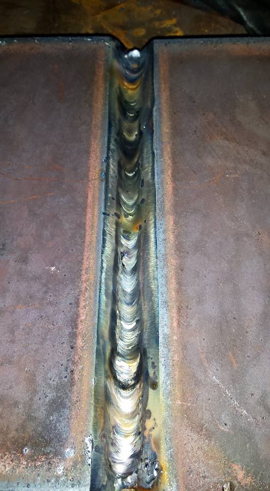

My first TIG root pass.
Not bad, according to the instructor.
(1/2" plate, 1/8" open root, 150A, WC17 Flex torch, gas lens w/12 cup, 1/8" 2% Thoriated)

Nice and neat, Rocket.

It was a 37.5degree bevel cut on each side (more room to practice and nail down technique) with a free style weave. I did not walk the cup...yet. I prefer to learn the hard way first to get it out of the way.MosquitoMoto wrote:Nice and neat, Rocket.

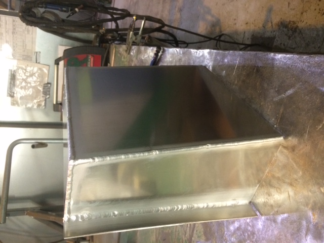

My first alumimium project. It's a outside "Instrument panel" for my brother's boat. All though, there wont be any gauges there, just a steering wheel.
I enjoyed working with alu, but maaan i had problems with the welding machine. Sometimes the machine just didnt weld.. The arc was there, but no heat envolving. And sometimes the arc wandered all up in the torch.. I dipped the tungsten often so maybe it was due to contamination. Sorry for the bad engrish

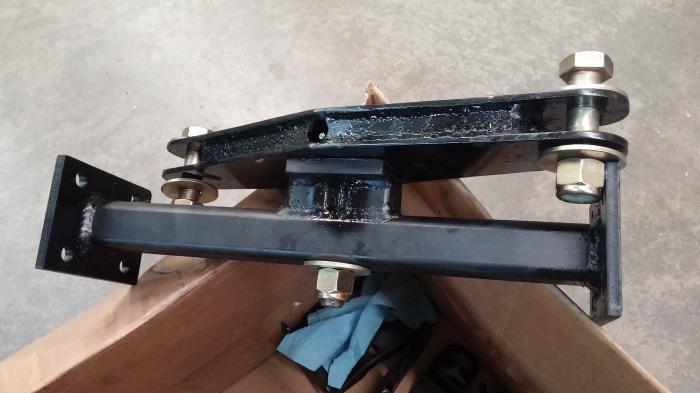

I made this watts system for a pretty big diesel coach {21000 EW}. Think home on wheels... Guy was looking to get most of the steering issues resolved. Said that it was somewhat of a fight in crosswinds,passing other road tractors and sway issues. I told him that I had the software to lay out all this to work with the chassis and could make and install it. Odd lot of molly tube,1- 1/2 x 1/4 sq tube , 3/16,1/4, 1/2" plate, rods ends and the like hardware. He specified it be a bolt on item...complied most of the way on that. He is a happy camper now...no pun intended. I know it was overbuilt, but covered more than problems he was looking to cure- plus he's just a good guy and friend. Home on meds after operation today...just wanted to share. Job done last fall. pix out of order...sorry

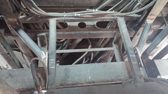

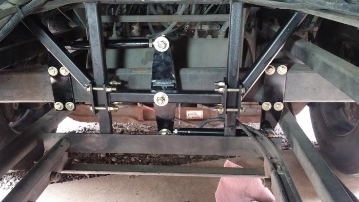

Genny moved out to get up into the hole to get all the pieces in place. Done deal here with all the goodies installed. Has a few long road trips on it and is doing it's job as reported. The suspension on these are axles/wheels mounted onto an "H" frame and suspended via airbags to the frame. Seems a lot of these could be made a little better for as much as they charge to drive off in one. Underneath these trucks are busier than a cat in a room full of rocking chairs with hydraulics, plumbing, pneumatic and electrical items.

I take it the principle is to eliminate toe-steer by fixing the axle rigidly from transverse motion?
Nicely done.

Actually the trailing arms and bags are all that the front end was riding on. It was tracking all on its play in the sway bar link bushings...I know they were screaming for a break! All mig welded with Millermatic 250...Tig on the .120" round link bars" rod ends.
