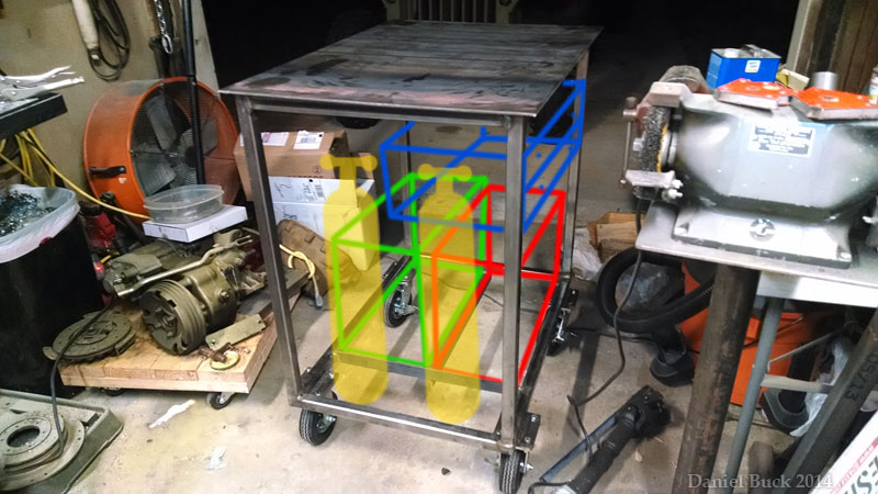

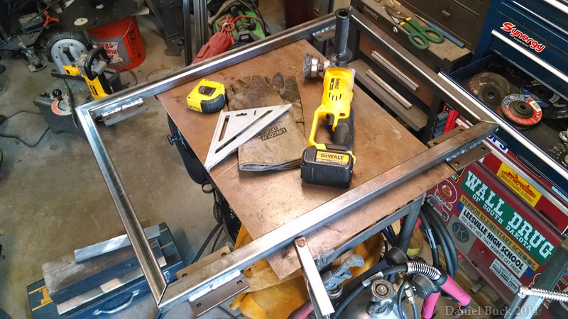

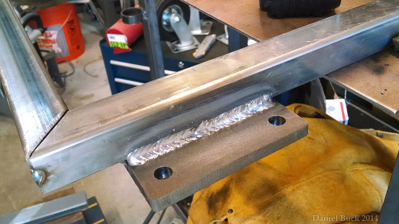

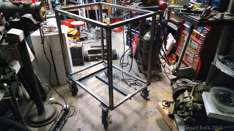

making a new, larger welding cart. Since I now have two welding machines, and two gas bottles to go with them. This cart will have larger wheels/caster, the smaller ones on my old welding cart were a paint to roll around over even the smallest of cracks or bumps in the concrete. And the new one will have drawers to hold things in.
In the last image, you can see the two welders (the bottles will go behind the welders, looking at the back of the cart in this view) and the drawer above the welders.
Most of the structure is done, need to put some horizontal pieces to hold the welders and the bottles, and mounts for the drawers.
Tubing is 1.25x1.25" .120 wall. Top is a bit more than 2'x3' 1/4" plate.

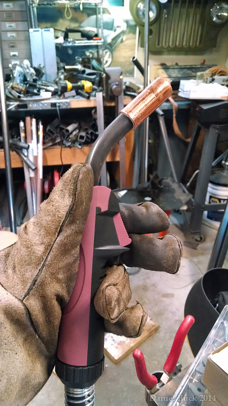

Breaking in the new PINK HTP welding gun. Why the heck is it pink!? haha!

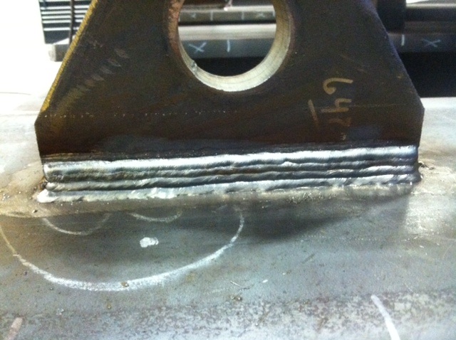

Nice job stacking those stringers, keeping it flush with the plate. You mentioned a 5/8" bevel, so is this partial pen joint also welded on the other side of the lifting lug the same way?(5/8" bevel filled out flush?)Superiorwelding wrote:The lug is 2" thick and it required a 5/8" bevel with little to no weld sticking out past the plate.

Yes in fact it is a PJP. The engineer was very concerned that we his the 5/8"on all 4 sides. We were not allowed to install them until he measured our bevel. He almost changed it to a 3/4" bevel but I did my best to talk him out of it
No sense in welding more than we have to. If you look at the picture you can see a hint of roll over on the bottom weld as well as the top pass. I will be honest in saying I was probably playing around with the settings to much to try to get the nicest bead I could. The bottom pass already had a finish pass under it but in order to get the others to stack right I had to go over it again and was watching the top of the bead and not the bottom. I kicked myself after I was done and saw it but I can't allow the weld to go out any further and it is acceptable so no need in grinding. The top pass was a pure experiment. I didn't even try a practice pieces and that was the result. We have 4 more lifting lugs for the other 40' section so I will try to document those passes better as I know Steve is also interested in lifting and rigging. To be honest again, I used to be very nervous about welding lifting lugs and have slowly gotten over that. I am just as cautious but like a welding test, try not to let nerves get the best of me.
