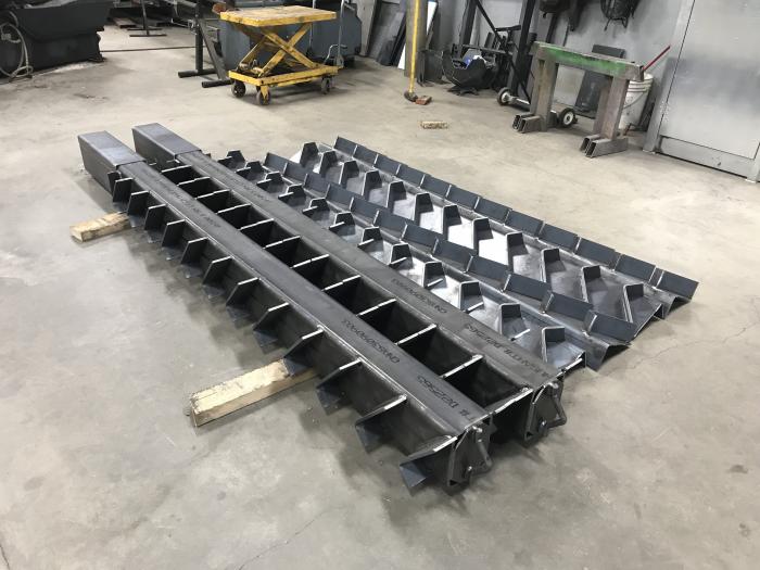

theaceofgates wrote:Sweating Bullets here in NM.......

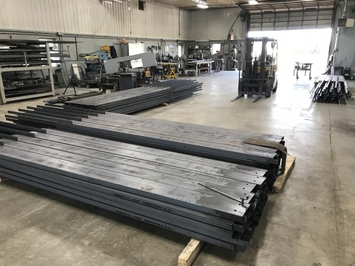

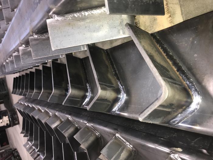

Got half the cross beams welded to the wall plates. Well actually closer to 3/4 but only got half of em packaged for shipping in the pic. Might have to extend the frames higher so I can fit more pieces in. Just dug em out of the scrap heap to package these awkward pieces.

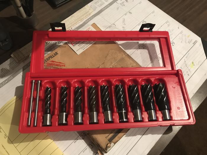

Started drilling the uprights too, anyways I made myself a jig to mark em And drilled 3 or 4 holes. For when I need a break from welding. I considered posting my mag drill in the tool review section but figured I’d wait till I’ve used it more first it’s still fairly new (couple months). I’m impressed so far, unbelievable power for a cordless too. Got the annular cutter set yesterday actually. Just under 1,000 holes to drill, and the c channel doesn’t fit into my punch. I didn’t want to use anything other than cutters, and decided to take the leap and get a set rather than just the 1 single size I need for this project. Dang they are expensive. I think I’ll lose sleep over that for a while. I’ll see how well Milwaukee cutters last, they seemed to be the best option for the money. Anyone have any experience with what are good annular cutters?

Use a good cutting paste.
https://www.rocol.com/products/chlorine ... al-cutting
This is some stuff I use at work and have had good luck with. It’s like a flux paste and it sticks to a cutter or hole saw.

Annular cutters are not cheap, but they pay for themselves in time saved. If you tried to use a twist bit to drill that hole, you'd be stepping into it with 3-4 bits. I use Hougen annulars and they seem to last pretty well. Trick is to use LOTS of cutting fluid. I have had my best results with Walter CoolCut. Its a water-based solution very suitable for Mag Drills.JayWal wrote: I considered posting my mag drill in the tool review section but figured I’d wait till I’ve used it more first it’s still fairly new (couple months). I’m impressed so far, unbelievable power for a cordless too. Got the annular cutter set yesterday actually. Just under 1,000 holes to drill, and the c channel doesn’t fit into my punch. I didn’t want to use anything other than cutters, and decided to take the leap and get a set rather than just the 1 single size I need for this project. Dang they are expensive. I think I’ll lose sleep over that for a while. I’ll see how well Milwaukee cutters last, they seemed to be the best option for the money. Anyone have any experience with what are good annular cutters?
I plunged 840 holes (.625x.750) with a single Hougen to drill my table. Took a while, but cost me $60 for a cutter, $40 for fluid, and only $200 in rum to placate me whilst drilling Or I could have paid about $2,000 to a shop to CNC drill them.

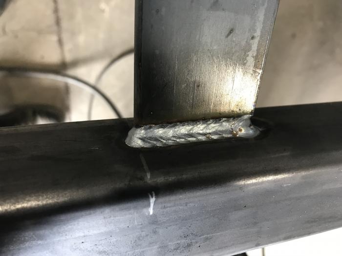

Ever since welding the plates at the start of this project ive been playing around with the pulse MIG feature and im really starting to like it. I was getting more crowned up welds than i liked, even with the voltage cranked up. But with the GMAW-P, setting the Trim higher, seemed to give more arc force, punching it into the the root of the joint more, and flattening the bead. So i didnt need hardly any gun manipulation, just slight whip and pause, then hit it with a wire cup brush and done.

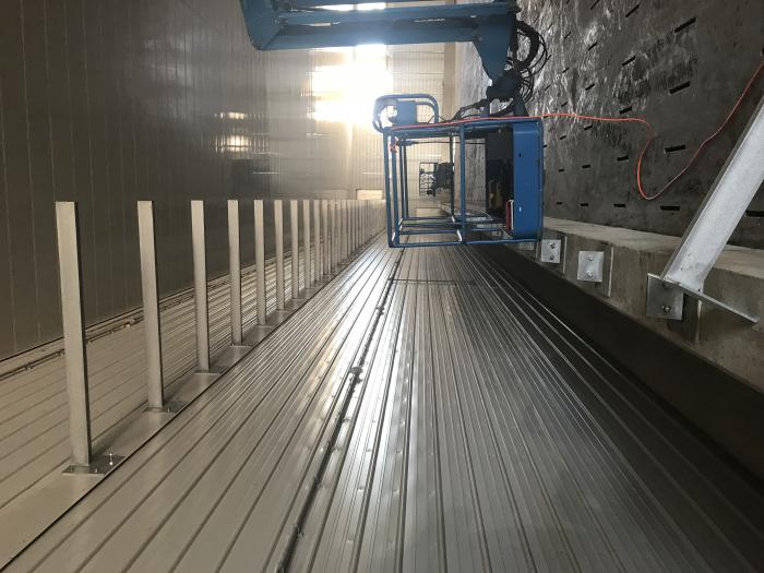

Aaand just finished up the last job for the shed, besides assembling the wall. Not sure what to call these, but on the last picture you can see 1 of the plates bolted to the wall on another shed. Then you slide 3x8 boards or 2 ply 2x8s in as a sort of removable wall. That way there’s no swinging gates or doors, and you only take them out once a year to empty the shed and put em back in when you fill it. Simple, but works great. The doors on this shed are wider, so I made a center post to support the boards, made a 2 foot sleeve that will be cemented into the floor. So I can slip in the post, and lift it out with skid steer when emptying the shed. It’s a 2 bay shed, so 2 wall plates and 1 post per shed.

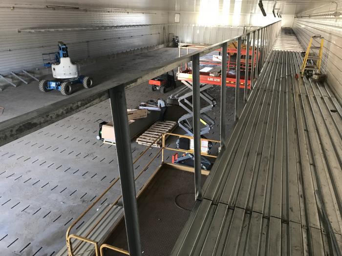

got most of the wall in one bay assembled. Everthings working out great so far

That’s half of em. The contractors are still working on the floor in the second bay. I’m not doing the assembly tho. I pretty much live in the fields in summer, especially during harvest which is starting in a week. Potato harvest that is. Which i kinda like it’s a good change. Welding and mfg in winter and farming in summer.tungstendipper wrote:That's a lot of work!
