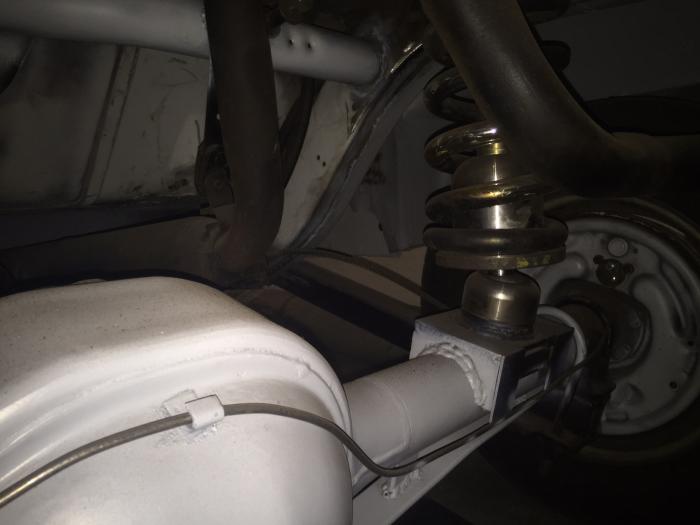

I welded 3/16" perches on the top of my Ford rear end. I welded them using my Eastwood MIG 135 in its highest setting of "J" using the supplied .6mm wire, gas shielding is CO2/argon mix. I did the first pass and them added two more passes for strength.
I did not even occur to me about using flux core wire and no gas option. Until now, I just read that the flux core option is the recommended option for thicker metal.
The car has not been driven or drivable just yet, but now I am concerned.
Should I go purchase .035 flux core wire, grind down the welds, and weld again or just pay somebody to fix this?
I'd think that Eastwood, run WFO with hard wire and gas, is sufficient. I'd feel comfortable using it, depending on what I observe as I weld. If you're not comfortable, or have limited experience with the machine, some practice may be in order, but the machine can do the job.
I can not recommend the flux-core option on a machine that small. Your results will be inconsistent, at best. I'd much sooner recommend SMAW than a flux-core weld with less than 250 amps.

Can you post up some pictures?
- image.jpg (38.46 KiB) Viewed 1331 times

In reading my door settings, it states that for 3/16 to 1/4" steel to use flux core .035 wire. I looking at some you tube videos under your channel here, it show what flux core can accomplish.
Please advice.
Thank you

For the type of driving you plan on doing i would think those welds will be just fine.
On another note, that is not a ford 8.8. A 8.8 has a removable rear cover. It LOOKS like a ford 9 inch which has a removable "pumpkin" that comes out of the front of the differential. It could also be a 8 inch, which looks very similar to the 9".

The Hydraulics push down to make the body of the car raise and its not pushing at an angle. We are talking about 3000psi to 5000psi of hydraulic pressure extending the rear cylinders.dsmabe wrote:For the type of driving you plan on doing i would think those welds will be just fine.

I think if you put a hydraulic pressure guage on your lines going to the cylinders that you would find that you have a lot less pressure than you've stated, unless the cylinders are fully extended. The rear of the car weighs much less than that and would rise before that kind of pressure could build until the cylinder extends it's full length. then you'd likely have no suspension at all, it'd be ridgid.
I think your welds should be fine in this case since the saddles would see mostly downward pressure and the function of the weld would be just to hold them in place. I'm no expert on suspensions though. Most things on a 1964 Galaxie around my neck of the woods would already be rusted thin and have less structural integrity than even the worst of welds. I was riding in a 1967 Galaxie when the rusted frame snapped and buried about 2 feet of driveshaft in the asphalt at 60 mph, raised the ass end of the car about 2 feet off the road. Stopped incredibly fast though.

I was watching a video here regarding Flux core welding with a small MIG 135 machine and the final attempt held very well when put on the press. After viewing that video, I feel that flux core welding with my Eastwood MIG 135 should do ok with 1/4" steel. That is my next practice attempt on scrap steel.
Its just for ride height, thats all.dsmabe wrote:Is the hydraulics only for ride height control, or is it going to be used for making the car bounce also?
If it's just for ride height them your fine, maybe 1000 psi tops. If your bouncing it, the pressure could be much higher!
You should be fine then. And the rough estimate of 1,000 psi tops was come up with assuming the car weighs 4,000 lbs with a perfect 50/50 balance front to rear and side to side. Then assuming the shaft on the hydraulic cylinders have a surface area of 1 square inch (approx. 1.13" diameter). If the shaft is smaller the pressure would be higher, and if it's larger the pressure would be lower.
