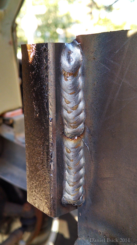

Looking to practice my uphill MIG welds, generally it's 1/8", 3/16" or 1/4" thick, T joint. Sometimes butt joint. anything smaller than 1/8" I always go down hill because I'm not worried about penetration.
This is just me as a hobbyist welding in the garage, this isn't for any certification or anything. Just general garage fab work, if that makes a difference. I've been using .030 wire lately, I've found that it seems to be pretty good all around. I can do 16 gauge, 1/8" 3/16" and 1/4" decently with it.
I wonder would running uphill beads on a flat plate be of any help? I kind of hate to waste material making T-joints. Would a plate full of up-hill beads every now and then be good practice? Or is it worth it to actually make the joints? I usually avoid uphill welds, but I'd like to get good at them.

I had a few minutes free in the garage tonight, so I took two pieces of scrap and gave the "upside down V" approach a try. I'm actually quite pleased with how it turned out. MUCH better looking than when I just try to go steady all the way up, or when I weave back and forth. I also turned my machine down for what I would normally do with 1/8" tubing, I think that helped too.
When you stop and re-start a weld (like I did here, in the middle), any tips for getting it to look a bit more seamless? Next time I'm going to try starting a bit higher up, then dipping down back into the previous bead.
There isn't any under cut on the sides here, but it does look choppy. Is my V maybe to wide? Or not pausing long enough on the sides? Or maybe to much space (vertically) inbetween my V shapes? I'm only pausing slightly on the sides, and tracing the upper edge of the puddle. I haven't tried the triangle yet.
I don't like the way lincoln sets up their dials, but for the wire speed I was using 5.5, and amps was set to H.
Whatever that means. Which is basically one step down from what the chart suggests for 1/8" material. I generally run hotter than what the chart suggests, but for this vertical weld, I think having less heat and moving slower seems to have worked out. When I try it with more heat and I move faster, I get a tall thin crown in the center.
Definitely penetrated well enough. it's popping through the back side a bit on both pieces (this is two rectangle tubes, not flat bar, left over scraps from a friend's project).

Looking good! Not bad at all, I generally try to use the upside down V technique most of the time with great results. The only critique I have is watch your tie ins. Still looks good. ![Smile :)](./images/smilies/icon_e_smile.gif)

yea, I definitely want to work on my tie-ins. I do start and stop alot.

Your vertical up is looking good! As a personal preference in would tighten the weave up but you are doing great.
