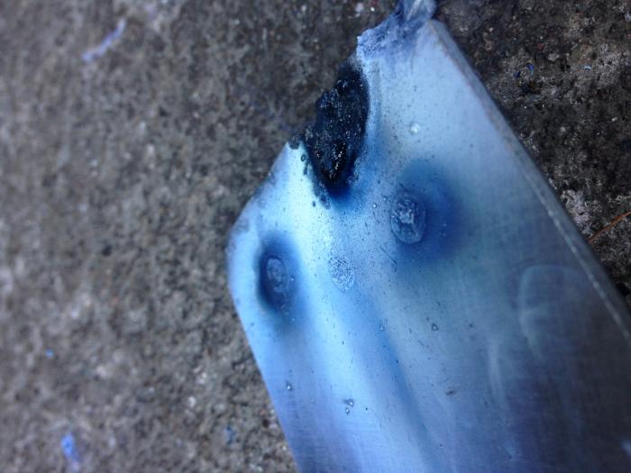

I have some parts that I tack welded for work. Don't know the grade of metal. Welding .125 to .052. I started the weld on the thicker piece and washed it over to the thinner metal. For this application tacks are all that is needed. My question is what causes the black soot. It seems to be more pronounced when the weld is done on the cold side. Thanx in advance.

Using a gas lens I had a 3/4 or so stick out to see what I was doing.........gas problem something to think about.
The black soot means that either
A. You dipped yourr tungsten into the puddle
Or
B. You allowed the puddle to grow into the tungsten.
It's one or the other but it's usually B. Usually doesn't cause a problem unless you get a big glob on the tungsten. When that happens it will weld like total crap and you have to change it out. If it's just a little bit on the tungsten then it usually burns of within a few seconds.
Or

I have had the same problem with some beads and I found has was the issue. Just turned it up a few cfh.exnailpounder wrote:Gas problem....next case

Man, way more amps and hit it faster.
When I was welding 1/4" to 1/16" I was still over 200 amps with the tungsten pointed almost entirely on the thick piece.
The soot I see is from not forming a good puddle before adding filler.
MinnesotaDave wrote:Man, way more amps and hit it faster.
I do that consistently, not waiting for puddle

I'm going to be the dissenting voice here and say there is nothing wrong. I get black soot like that outside of the etching zones on a lot of my tacks and that is with a new clean tungsten, before I introduce filler, and I know the gas coverage is good. It seems to depend on what grade I am welding. It happens a lot on 7005. My theory is that it is the high zinc in that grade. It does seem to improve a bit as the metal generally heats up. Maybe I should try pre-heating. The tacks are nice and clean though, so I just wire brush the soot away and start welding.
If it's not the things you brought up, I usually see a wide cleaning band like that when someone uses too little amperage and "cooks it" waiting for a puddle.RamboBaby wrote:That's an awfully wide area of cleaning. Where do you have your ac balance set? It almost looks like you're burning back some type of clear coat.

Perfectly fine for thus application.zank wrote:I should add though that there is no fusion near the root and the joint is just bridged. Is that ok for the application?

Right on the money Dave. You have to take into account my limited tig skills especially on aluminum. When I cut the parts to be welded I cut extra because I knew a burn thru was more than likely......and I did burn thru a few.MinnesotaDave wrote:If it's not the things you brought up, I usually see a wide cleaning band like that when someone uses too little amperage and "cooks it" waiting for a puddle.RamboBaby wrote:That's an awfully wide area of cleaning. Where do you have your ac balance set? It almost looks like you're burning back some type of clear coat.
