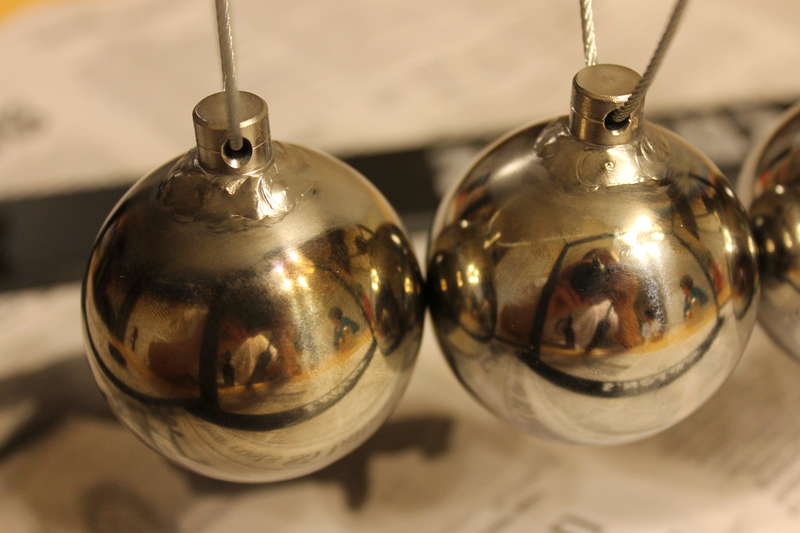

I made little "hats" to go on each ball -- each hat consisted of a .300" long section of SS rod turned to .400" diameter, with another .100" long section turned to .5" diameter. I drilled a 1/8" hole through in the middle of the .300" section. I radiused the bottom of each hat to fit the 2" radius of the balls.
To weld the hat to the ball: I drilled a 1/2" hole through some scrap 1/4" steel plate and used this to set the ball on. Using one of the insect-like hold-downs that Jody featured in a recent video, I held the hat down on the ball. I made a tack on either side, just fusing some of the "hat brim" into the ball. Then I welded all around using 1/16" 308L filler. The results were a long, long way from pristine, but they are serviceable. Here are pictures of the results:

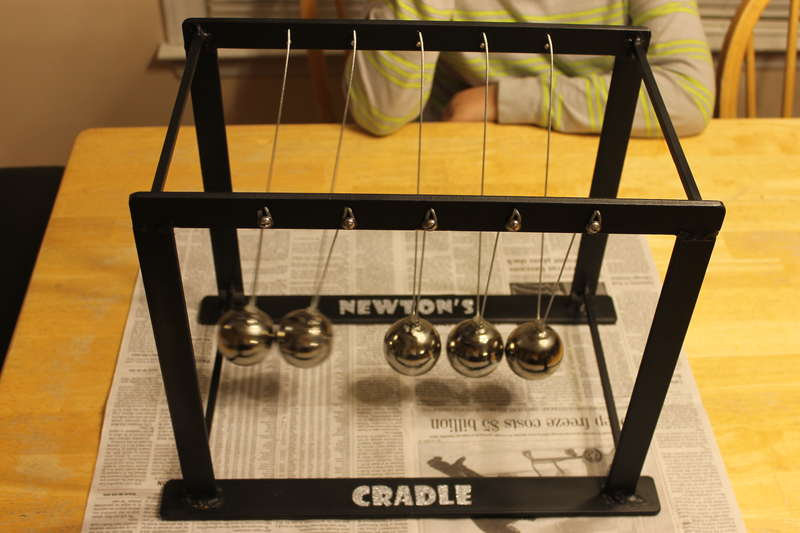

The complete unit:![Image](http://www.wakefieldphd.com/hobbies/IMG_8757.JPG)
Dimensions are 12" high, 14.5" long, 9" wide. Constructed from 1/4" thick x 1" wide mild steel bar for the uprights and top pieces; 1/4" thick x 1.5" wide mild steel bar for the "feet"; and 1/4" x 1/4" bar for the cross pieces. Welding was done (not very neatly) with 6011 stick -- I was out of argon when we did this part. My friend painted it as shown.
The top pieces were drilled with 5 1/8" diameter holes 1/4" from the top, spaced 2" apart; at the same spacing, but 1/4" from the bottom, they were drilled and tapped for #10-24 screws. The steel wire used to hang the balls was fed through the top hole and looped around a machine screw+washer which was screwed down firmly to hold the wire in place.

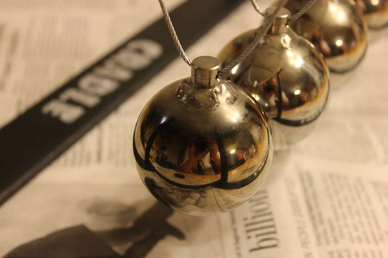

Closeup of the system used to hang the balls:![Image](http://www.wakefieldphd.com/hobbies/IMG_8771.JPG)

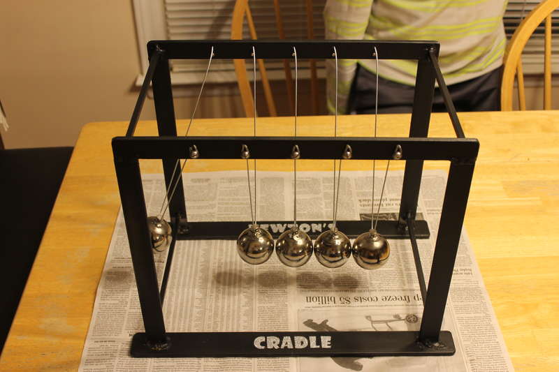

Balls in motion (one ball lifted and let go):![Image](http://www.wakefieldphd.com/hobbies/IMG_8758.JPG)
![Image](http://www.wakefieldphd.com/hobbies/IMG_8759.JPG)
![Image](http://www.wakefieldphd.com/hobbies/IMG_8760.JPG)
Balls in motion (two balls lifted and let go):![Image](http://www.wakefieldphd.com/hobbies/IMG_8762.JPG)
![Image](http://www.wakefieldphd.com/hobbies/IMG_8763.JPG)
![Image](http://www.wakefieldphd.com/hobbies/IMG_8764.JPG)
Closeup of the hats welded to the balls. Not very pretty, but it works!![Image](http://www.wakefieldphd.com/hobbies/IMG_8767.JPG)
![Image](http://www.wakefieldphd.com/hobbies/IMG_8768.JPG)
Thanks for the help. My friend and his young son and daughter are delighted with the results!

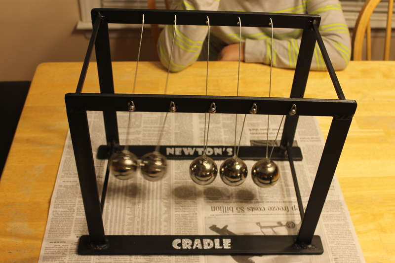

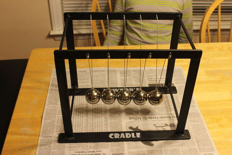

The complete unit:

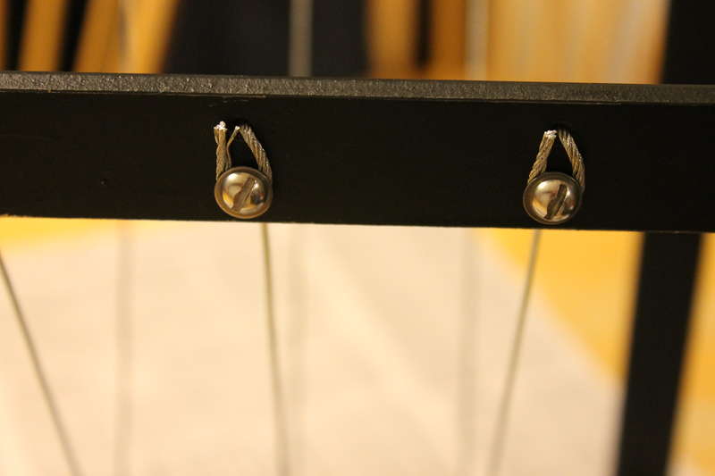

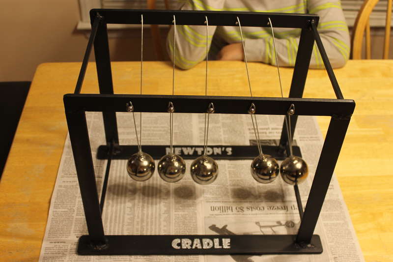

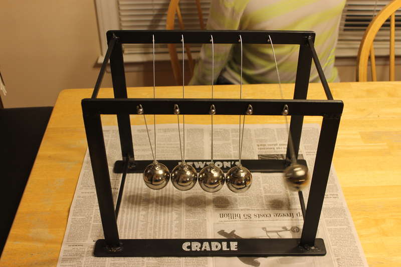

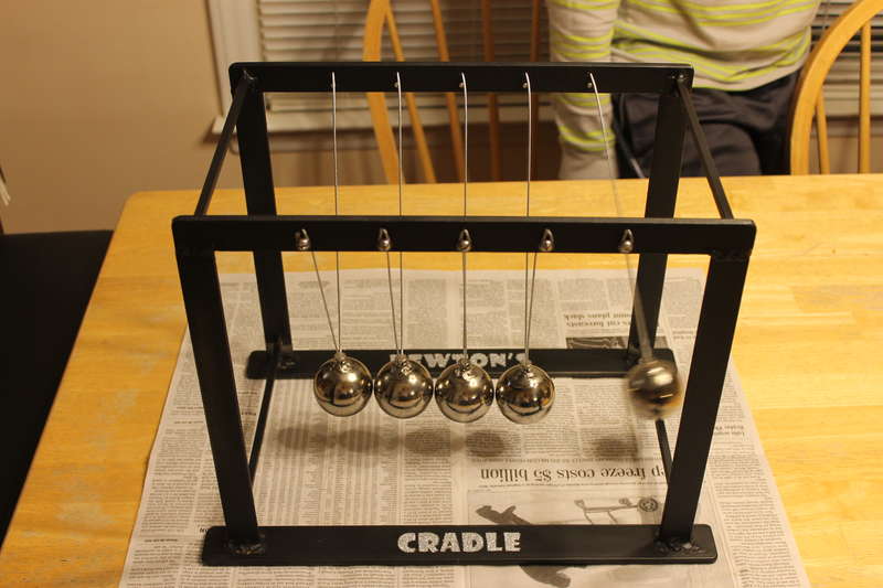

Don't beat yourself up on those welds at all. The product is the goal, and the result is brilliant!
