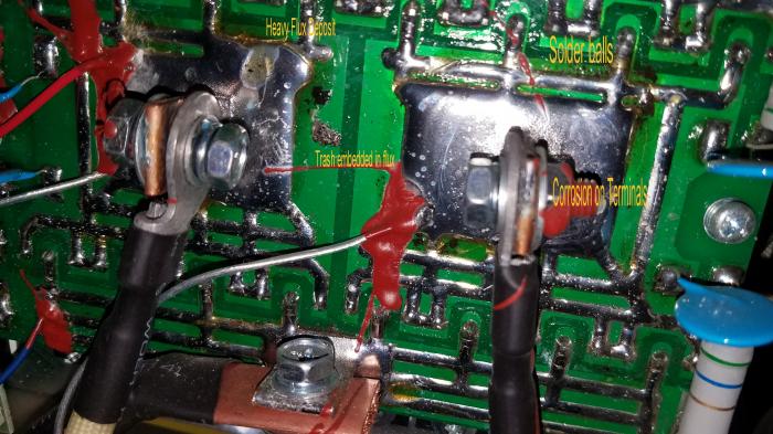

I have never seen a quality electronics company leave heavy flux on a circuit board like this. Even Rosin flux will eventually lead to corrosion. I spent an hour with 99.9% IPA, and a bunch of Q-Tips, to remove the flux, embedded trash, and a bunch of solder balls. These are basic housekeeping type items that any reasonable electronics company would never allow to get out the door.
In this photo, I had already loosened the terminal screw on the left, to investigate what looked like corrosion. I ended up wire brushing both terminal lugs, and treating with DeOxit.
