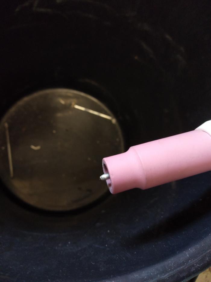

Hello my name is Peter, new to the forum and first thread.
I'm struggling to get a weld pool happening, I'll attach some images, any ideas?
Lincoln 201 AC/DC Tig
Settings:
AC have tried with and (mostly) without pulse.
Amps 80 to 140 3mm (4mm piece tried up to 200).
AC frequency tried 50 to 100.
Balance 10 to 50%, mostly around 25-30, 50 ate the tungsten fast.
Pre flow 3 sec, start amps 20, up slope 2 sec, down slope 2 sec, end amps 10, post flow 5 sec.
Using 2T.
No. 6 cup.
2.4mm 2% lanthanated tungsten.
Gas flow I have tried from 6 to 15 LPM mostly 7 or 8.
So a typical setting is...
AC frequency 75
AC balance 25
Amps 110
No pulse
Gas flow 7lpm
Tungsten turns blue/grey quickly.
Can't get a clean weld pool, crusty black pepper, material starts to sink, just seems to almost blow through large area (see underside).
Material is brand new just peeled the plastic of it, wiped with acetone also.
Any more info required? Thanks for reading.

My comments, not an expert or even weld with aluminum, waiting on my first AC capable machine as I type.
1) Your bottom image looks like a gas problem. Yout LPM looks correct as CFH is about twice, so I think that is correct.
2) You didn't mention torch angle, and that may or may not be an issue.
3) Your tungsten looks contaminated.

I agree it could be a problem, along with the long stickout. All 4 have to work together: gas flowrate, stickout, arc length and torch angle.TraditionalToolworks wrote:2) You didn't mention torch angle, and that may or may not be an issue.
This is my stickout with a #7 cup, and I use a gas lens! Compare:
My arc length is for the most part never more than 2-3mm. If the arc is 4mm long plus 8-10mm of stickout, then the cup is at least 1/2" from the metal, factor in too much torch angle, and you lost a lot of shielding gas coverage.

the tungsten looks like a gas issue. check collet, back cap is fitting and sealing on the o ring. cup is sitting properly on the correct insulator.Peter69 wrote:Hello my name is Peter, new to the forum and first thread.

no leaks in the hose connections.
your stick out looks really long. try about half that.
your post flow may not be long enough. hard to tell if you have a gas issue. might pay to extend it to 10 seconds and see if the tungsten changes color before or after the gas stops.
having a contaminated tungsten doesn't help.
pre flow is typically 0.3 sec. often hear the pulse of gas come through.
balance 30 is fine.
amps, still at bit low for 3mm.
aluminium you want a fair bit of heat so it puddles in a few seconds. if you sit and wait for a puddle you end up overheating the work piece.
one of the reasons you want decent post flow time is to let the tungsten cool down from high amps. if its to hot when the gas turns off it will oxidise in the air.
the only catch is tungsten grind. i think many people do a grind the same as what they do for steel which is a fine point. problem with that is if you hit it with high amps it melts back or outright blows the tip off and that can containment the weld.
someone once mentioned to make it look like a crayon tip, which i think is about right. quite a steep grind with the tip cut off.

Regrind tungsten, shorten stick out, extend post flow, check when tungsten discolouration occurs. Wire brush aluminium.

You forgot two important ones.Peter69 wrote:Thanks for all the replies, I will implement the ideas tomorrow and see if I get some improvement.

Ok so I've implemented the changes, the biggest improvement I think came from tungsten stick out length. Tungsten remained clean and some beads were formed.
I decreased pre gas flow to 1 second and increased post gas flow to 10 seconds.
Amps increased to 110, I tried 120 was getting a little warm, trial and error from here.
AC frequency 80.
AC balance 30.
Thankyou for all the suggestions, obviously need a lot more practise and some tweaking of settings but at least I now have a base to work off.

There's some crud on the end of it, maybe it's just the pic.Peter69 wrote:Ok so I've implemented the changes, the biggest improvement I think came from tungsten stick out length. Tungsten remained clean and some beads were formed.
I'll take a guess as Oscar might have other things in mind, but I'm gonna say:Peter69 wrote:What did I miss?.
1) angle of your torch
2) distance of electrode to metal
Both of these will greatly effect the weld. If you keep the electrode too far away the arc will fan out and become erratic. You should keep the distance of your electrode to be within 1/16" - 1/8" from the metal if possible. If you angle the torch too much the gas will shoot out beyond your puddle and create problems as well.

pre gas flow can be really short. 0.2sec is heaps.Peter69 wrote:Ok so I've implemented the changes, the biggest improvement I think came from tungsten stick out length. Tungsten remained clean and some beads were formed.
AC frequency 80.
AC balance 30.
that still looks like your grinding a long skinny taper on the tungsten.
see how it looks now, thats kinda what you want to grind it to, tho i would use a much steeper angle.
as far as amps go, you really need more. but keep in mind a small bit of aluminium like that will heat up really quickly and reduce your need for amps.
so let it cool right down between beads. need to get used to having high amps at the start.

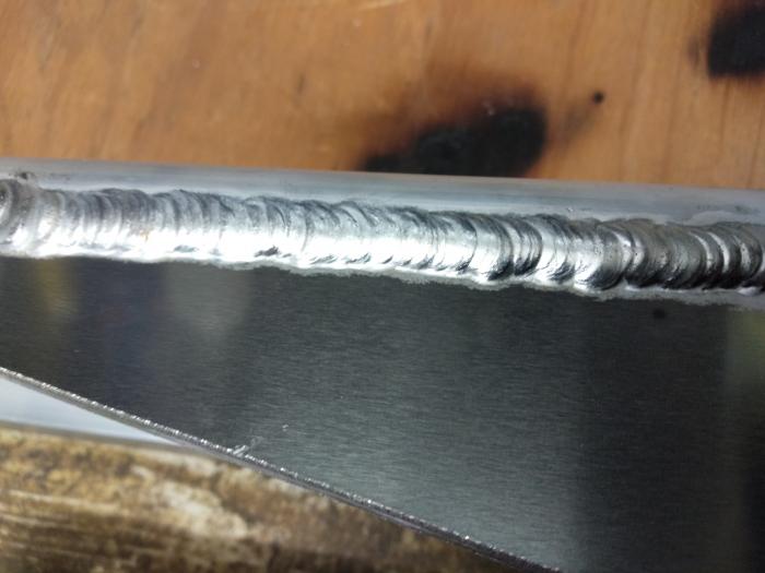

This was on some 47yr old 1.6mm painted aluminium cut and cleaned off a tinny, 80 amps

Peter, you're getting it...just try running beads for a while before adding filler. You'll want to end up with a nice shiny line of beads all being the same width. Don't rush it, it will take practice and then it will take some more practice. I found that thicker material is easier to learn on. Have fun with it and be patient ,, Grasshopper.

Thanks again for everyone's comments and help, starting to get the hang of this!
