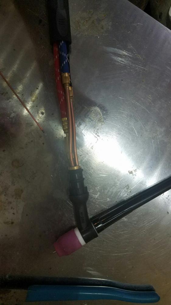

nope, haven't pulled anything apart. It all came assembled, torch on the end of some hoses with a zippered cover. 25' long. Havent even unzipped it yet. wp 280 weldcraft I believe is what miller calls it. It would be nice if I could just buy one of the $100-200 dollar flex head ck torches and hook up to the cables and zippered cover I already have. I just don't even know what to look for? hence the question.

Okay, I get it. Ill unzip and post pics. It is water cooled. This afternoon sometime. Thanks so much.

that torch indeed has standard water cooled connections. The argon and water inlet hoses are held by a threaded fitting that binds the hose against the tube by means of physical pressure. The power/water return hose has a female 1/4"-20 fitting that threads onto the torch itself. The CK torches that are designated as 2-series will have the same connections. You won't go wrong with CK torches. A CK dealer should be able to order you the torch itself without the cables. You can go to the CK Worldwide website and download the parts list PDFs so you can get part numbers and also look them up online yourself. Tec Torch also makes excellent torches. I use CK & Tec Torch torches. I think Tec Torch offers very innovative products.
I agree with Oscar. The CK torches will be "plug and play" with those hoses. The water return/power cable hose will thread right on, and I'd suggest trimming the water supply and gas hoses about 1/2" so you eliminate the "dents" the barbs will have on them and start fresh.

Trimming the existing hoses. When you break it down to change it, you'll understand.
The power fitting has a threaded flare fitting that wrenches off and on, and needs no modification. The gas and water-in fittings are rubber hoses that slip over barbs on the torch, and the CK uses a threaded collar on the torch side of the fitting to secure them (brilliant design). Removing a 1/2" from the existing hoses removes the dents (the "set", if you will) given to it by the previous torch's hose barbs. Lesser torches secure these two hoses with twisted safety wire, and losing that dent is a good thing, too.
