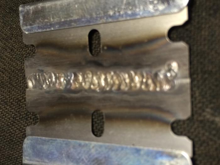

16 amps .040 2% lanthinated, .025 safely wire, 400 pulses per second, 40% pulse duration. At that low of an amperage setting my machine doesn't allow me to set background current so l assume it defaults to it's lowest value which is 4 amps. I need to get better control of my dabs. The lack of shielding at the end is totally my fault.......i sneezed.
High speed pulse is amazing. It is very noticeable how much more control over heat input it gives you.

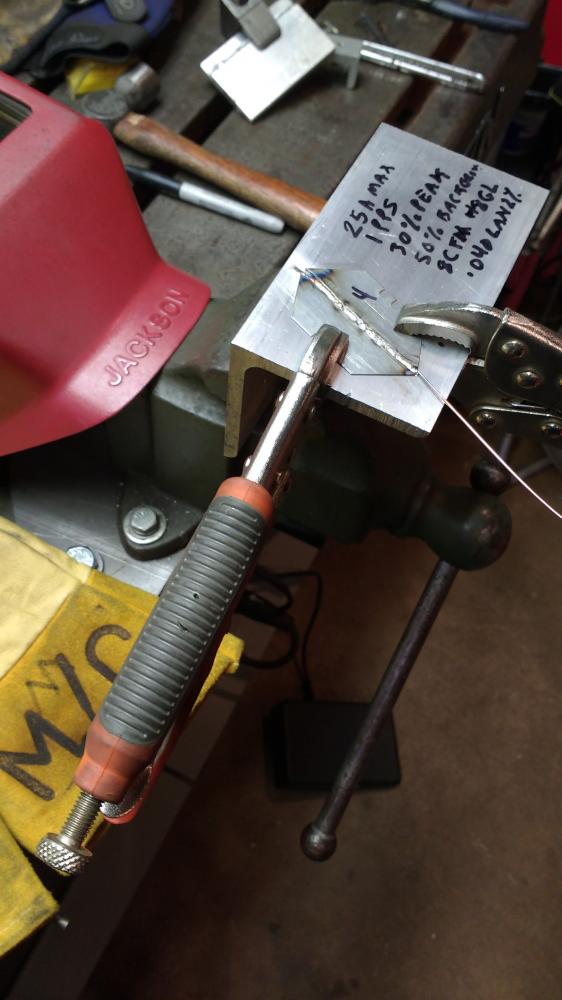

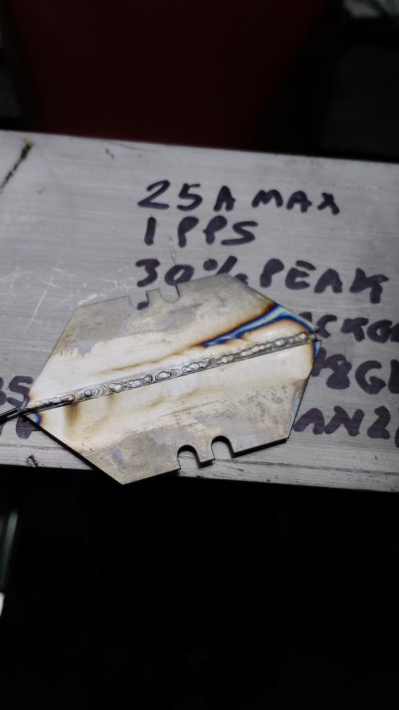

This is my #3 try at it.John Chamorro wrote:I sort of got it! My first was a disaster. After reading all the tips I did a slight lap with 1/16 tungsten, .032 safety wire at 18 amps. My biggest problem was staying on the joint. I couldn't see it at all. I went back over it staying off to the side a bit. It aint great but for my second shot at it, it ain't too bad. I'll post a pic when I get my pc back from the computer morgue.

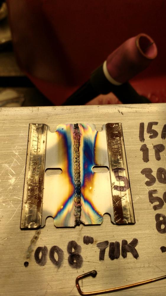

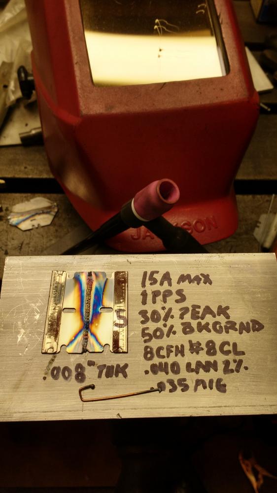

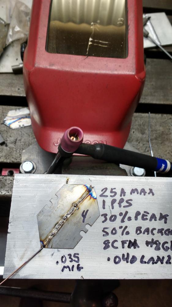

OK, Ifeel like this is a little bit of a cheat. I used pulse, so it's not all man, the machine did kick in some effort here, but I was able to use .035 mig wire on both kinds of razor blades. I do think the fixed #9 gold shade helped. I also basically used laywire technique and lit off with the wire on top of the blades at the start. So while I don't feel it's 100% in the spirit of this challenge, it was an excellent demonstration of how good pulse can be on thin material. Need to get some smaller filler so I can try these again for real.

- safety razor .008"
- IMG_20160826_160218473_HDR.jpg (66.01 KiB) Viewed 1197 times
- front .008
- IMG_20160826_160225515_HDR.jpg (76.31 KiB) Viewed 1197 times
- back .008
- IMG_20160826_160232266_HDR.jpg (69.91 KiB) Viewed 1197 times

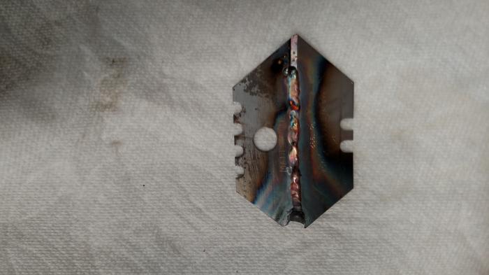

Nice job! The pulse was the key it sounds like. I couldn't get .035 or even .030 mig wire to cooperate when I tried it. Now it's time for a filet weld. Jody actually has a video on how to do it.

Gonna cost me more than $2! Smaller diameter filler, make/buy/cobble diamond wheel tungsten grinder, maybe a 6 shade gold filter, razor blades... And since this is the only project I have done with the new machine I basically spent 5k to weld razorblades together!
I like that everyone that tries this as a challenge, effectivley wins, as they will undoubtedly learn something. Dropping the gas flow to under 10cfh to get better puddle control is something I probably would not have worked out on my own. Putting that one in the trick bag and I bet it will get used more than once.

I have some .035 silicon bronze MIG wire I'm going to try as filler. Should be interesting.
