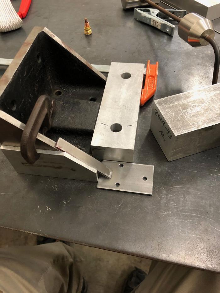

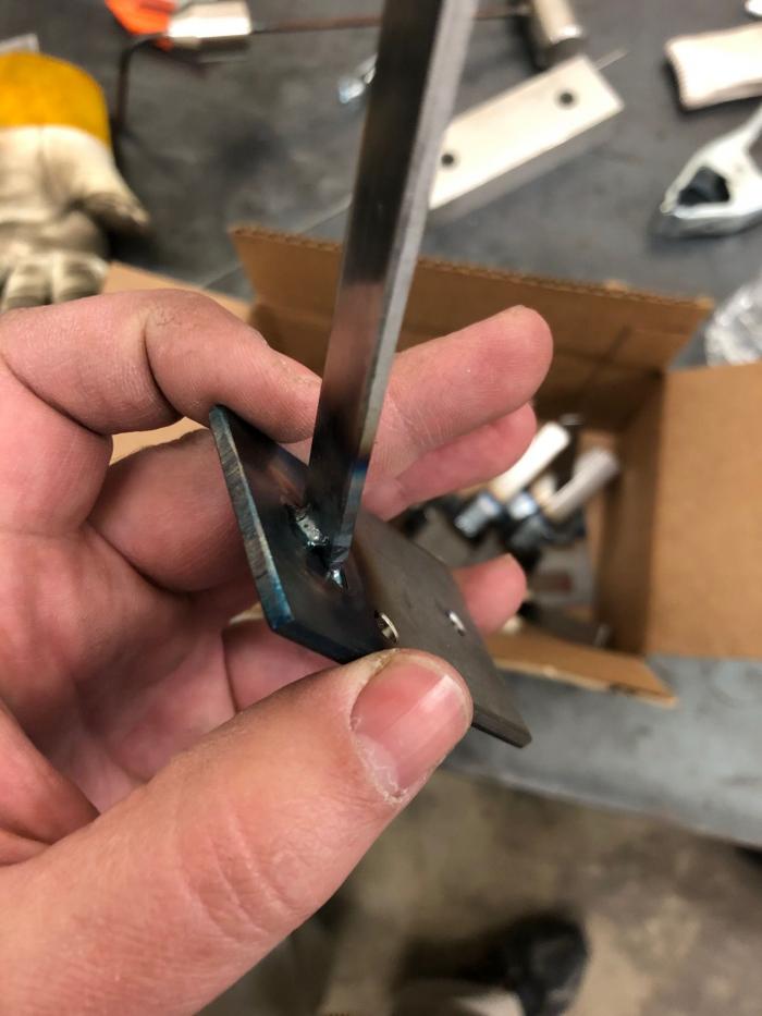

Little gravy work on New Years. Customy hanger mounts. 1/8" thick flat bar pieces set to a 45, only about 2.5" long. Just a quick run on the front and then a couple dabs on the back for added support. Wish I had a few thousand of these to do

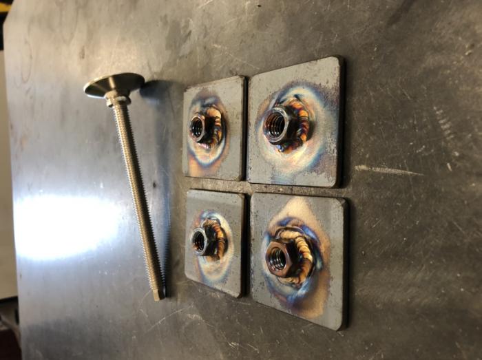

Foot nuts!!
And nobody will ever get to see them. Like a pretty little hidden secret on a table that was otherwise welded out with stupid MIG.

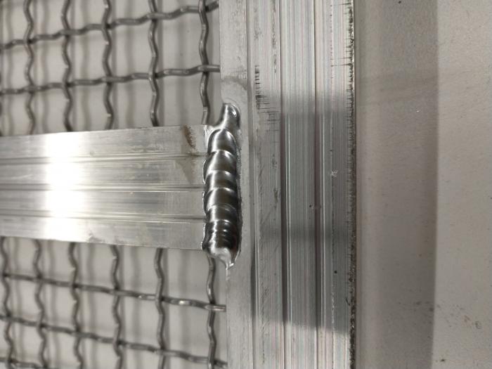

Spent today making a few ventilation screens for an aircraft engine test cell. Two of these side by side will offer ventilation for the engine to go through test. Rough opening size is 12 ft by 12 ft. All of it is 6,000 series aluminum.there are either five or six more test cells to do later on.
I wish I had a camera on the center braces when I weld them because they're a great example of a very heavy aluminum part and a very light part. You really have to lean on the outside frame hard so you don't melt away the center brace. It isn't difficult but it's interesting to see I'm about one and a half tungsten thicknesses off-center of the part ing line when I weld it. About 80% or more of the energy goes into the one outside frame.

Bill, it's been a while since I did anything that big. They're actually sorta fun to do. I had to take the welder to the framing area to weld them right on the assembly table because they were too big to move.
Dropped my torch that was laying across the welder and broke my very first Furic cup doing this job. I have dropped the torch before, evidently it didn't hit in such a way to break the cup. I also stumbled / lost balance while welding and did a massive tungsten dip a while back. That filth'ed up another one which I tossed. That one also got burnt when I had turned the gas off and started welding and messed it up more. So, in a year, 2 cups went in the can. Probably still not too bad.

I only use those furick glass cups when I absolutely have to. I seem to break one every time I put it on the torch. Sure is nice in dark tight spaces though. I especially like them if I'm using a mirror to see where I'm going. I dont ha e the luxury of welding on a table though. Usually on my back up under a darn pontoon boat.
