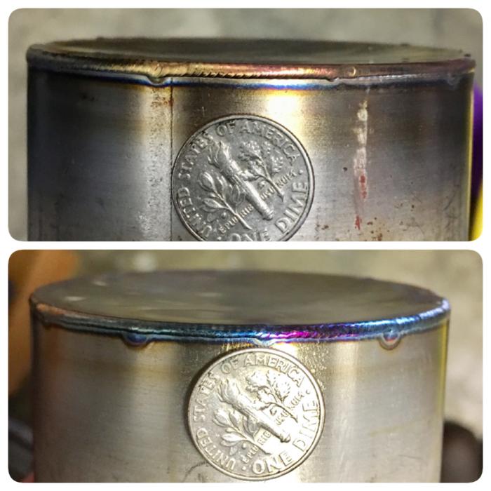

Did these guys last night for a coworker. Hes using them as fishing bells. 2" Stainless pipe, turned on a lathe to .070T. The top is .020T. The thin top made it a little challenging to not blow through it.

Jernigan 78 Nice work, I typically use pulse and some thin filler, work quick and try not to stop....torch angle is everything next to the fit up.

Nice weld, did you either rotate by hand or use a rotator?jernigan78 wrote:Did these guys last night for a coworker. Hes using them as fishing bells. 2" Stainless pipe, turned on a lathe to .070T. The top is .020T. The thin top made it a little challenging to not blow through it.

Rick_H wrote:Jernigan 78 Nice work, I typically use pulse and some thin filler, work quick and try not to stop....torch angle is everything next to the fit up.
Others, thanks for the kind words
Thanks Rick

Thanks Richard. I did use a positioner for these guys. I love using it. One shot all the way around. Fast and consistent.LtBadd wrote:Nice weld, did you either rotate by hand or use a rotator?jernigan78 wrote:Did these guys last night for a coworker. Hes using them as fishing bells. 2" Stainless pipe, turned on a lathe to .070T. The top is .020T. The thin top made it a little challenging to not blow through it.

Very nice! I have to ask though...what is a fishing bell? When I was a kid we had little bells we clipped on our rods at night so we could hear if we got a bite...same thing?jernigan78 wrote:Did these guys last night for a coworker. Hes using them as fishing bells. 2" Stainless pipe, turned on a lathe to .070T. The top is .020T. The thin top made it a little challenging to not blow through it.
