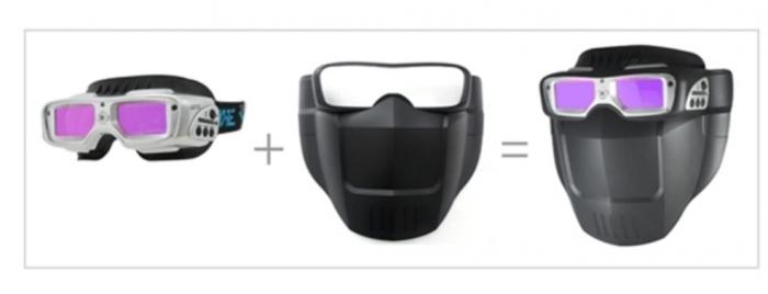

I can't see squat, so I've been thinking about this, but it might sound dumb.
What about welding with some of those flip-up type goggles, if I can find some with a #10 lens, while also using an pipeliner hood, but with only a clear safety lens installed?
Wouldn't that keep the light out of my eyes, because a dark shirt over my head is giving me heatstroke?

You must be desperate to use goggles, with a clear lens helmet.
Look at this pic here.
Just stack three clear lens in one of these helmets, than try your goggles.
Those flip up lens pipeliners are SO $%#& heavy!!!!
I couldn't stand to have on an my head all day.

While this could be done for a short period of time I cannot recommend this for a long period of time. To my knowledge the clear lens' do not offer uv protection therefore your face would be exposed to burns. Also the light would in theory reflect around the helmet causing your whole head to be exposed. If you are conserned about the heat and want to protect from the light I would recommend either a leather or cloth flap attached to your helmet or ultimately a fresh air hood like a Miller Titanium. Now hear me out...they are expensive but if you are doing this on a daily basis and are getting to hot this will fix both problems. Just a thought.

Good point but I did want to share options. With that said I would go with the shirt or leather on the back of head or change positions where he is welding. Another option is to build a Hoosier pole.

I appreciate all the replies. @MinnesotaDave That's one cool ass welding helmet.
I forgot about the UV rays coming through the clear faceplate, cooking my face.
Back to a regular hood and some clear lens doggles to block out all the surrounding reflected light. Maybe the hood just doesn't fit my head properly, idk? Too bad I don't have more hair to block the light. My welding hood is a Kobalt from LWS.
