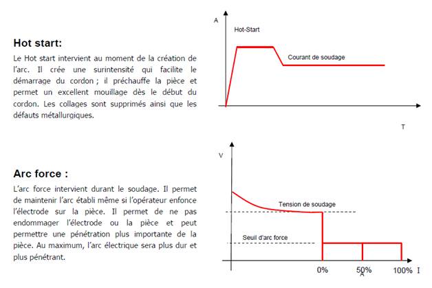

hello.
here are the graphs I had from my provider
seem like arc force add a given fixed number of volts, but also more or less amp depending of the regulation
Please can you tell me if I read that correctly ?
Thank you, sorry for the OT (not totally)

You are not reading the graph correctly.olek wrote:hello.
Volts (V) are the vertical, current (amps) are the horizontal.
As volts goes down (arc length decrease), amps increases (goes to the right).

Thank you, so arc force make it impossible to go to 0V (shortage ?) but, when arc force begins, it add some volts or only amps (?)
on the hot start sketch amp and V are inverted

No, you can still stick a rod on many machines.olek wrote:MinnesotaDave wrote:You are not reading the graph correctly.olek wrote:hello.
No, the hot start graph clearly labels amps and time - it gives no information on arc voltage.
Thank you Dave, I really misunderstood that one (thinking T was "tension" )
