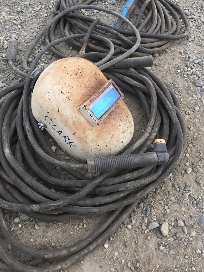

I finally bought one of these 3 or 4 months ago.
It's about 3/16" thick, so will fit in pretty much any helmet....
Arc color is an amber shade, and is really a good shade for seeing.
I've used it for mig (hard wire), stick (6010/7018 etc) duelshield, and aluminum mig.
Has never flashed me.
I've been welding in a lot of tight, poor visibility places, and it has stayed consistent.
Highly recommend.
I know, I've been a long time defender of fixed shade lens, but really, it's the 21st century.
Some jobs are just plain and simple easier with AD....

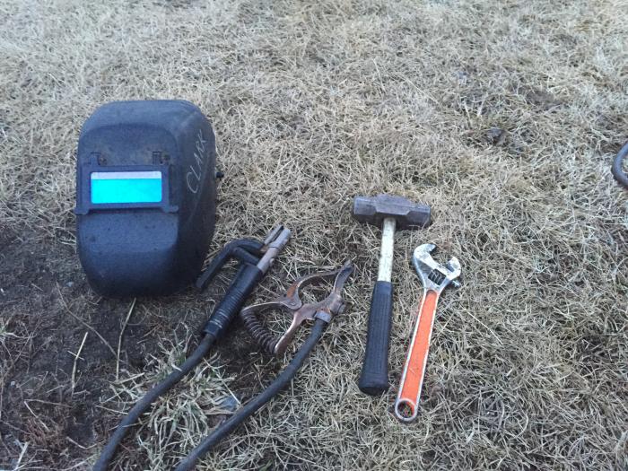

Lens is doing great.
It's my go to for just about anything.
![Image](http://weldingweb.com/attachment.php?attachmentid=1315971&d=1452234113)
![Image](http://weldingweb.com/attachment.php?attachmentid=1315981&d=1452234160)
![Image](http://weldingweb.com/attachment.php?attachmentid=1317051&d=1452321185)
