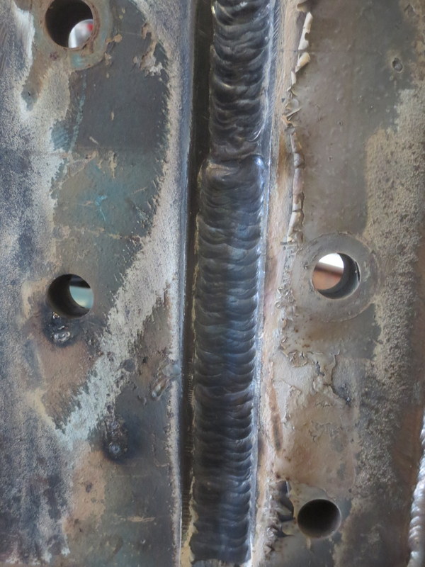

I'm really starting to dislike all you Hydrogen haters. I make about 1.2 million SCF of it a day and don't have hardly any problems with welds failing.
I just welded up a steam drain yesterday with a box of 7018 rod that was left outside since Monday laying in a ditch that was full of hot water and the line was full of steam, I don't think a rod oven would of helped.
I too fall into the stick welding haters club and if it went the way of the record alblum I wouldn't be upset.
angus
- angus
the rainy shot, ten days of that. I was running 21B, the other four guys were running.... you guessed it 7018
it was an army corps job so you can be sure they knew what was going on. it's not a perfect world.
that's my shirt...who needed a shirt.
these rods I found in an open can under a shelf, age unknown.
wanted to try new welder so I ran some, dirty rods, dirty material, worked for me. I sure wouldn't throw them away.
