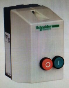

Maybe you don't need a circuit breaker if you already have one, just a local isolator:
Or maybe a d.o.l. motor starter with thermal overload fitted:
- s-l200.jpg (4.27 KiB) Viewed 5077 times
- s-l300.jpg (9.9 KiB) Viewed 5077 times
