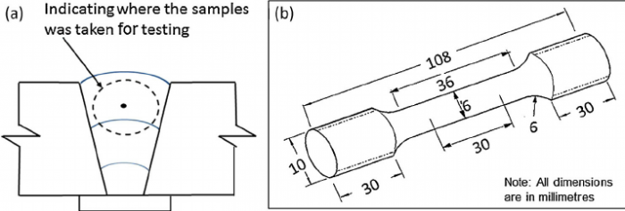

Ive seen an all weld metal tensile test welded. (not tested though) A test plate 50mm thick was welded with a big prep, maybe 25 degrees... then the weld is cut out with and a sample that comes from the centre of the specimen, this is machined into a sample that is totally weld metal, see pic.
- Fig-6-Tensile-test-a-All-weld-metal-in-longitudinal-direction-b-dimension-of-tested.png (105.27 KiB) Viewed 1826 times
Yes - done similar at school many years ago - but the only reason was the machine doing the testing was very small with limited available force & holding ability - it was'nt used much as there were sample pieces kept on display with it for common materials used in the coursework - the big Denison at college was huge & would tear most stuff apart - had huge taper grip jaws that bit deeper the harder it pulled - only needed to measure pieces for cross section prior to testing to quantify results which was'nt that big a deal as it was more how & where the piece broke rather than the tonnage.
